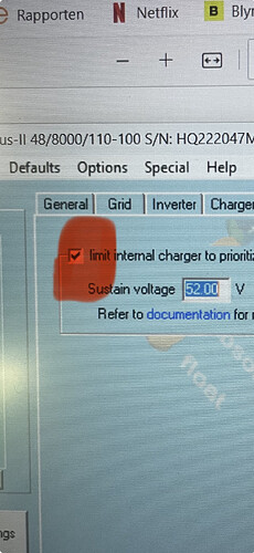

I had to redo all the settings. I think there’s a mistake in there too. I’ve looked at it so many times myself, but I can’t spot the mistake, hence the photo of my settings.
Remove the last page setting under advanced that is for solar wind priority and is not used with ESS systems.

Do you mean this one?
That is the one.
I’ll give it a try.

LX, thanks so much for the helpful tip. It’s working as it should again :blush:
