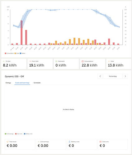

I am currently on fixed ToU tariff. I had tried DESS but it is incompatible with (ESS) Scheduled Charging which I want to use to top my battery to 100% each night on the EV rate. (Our feed-in tariff is much higher than this EV window so it currently makes economic sense to fill the battery overnight then export all excess during the day.)
This is all working great except I’ve lost the reporting on costs/earnings. If I toggle DESS on/off it works for a time presumably as that logic is invoked, but then a day or two later the charts are blank again.
Should/can regular ESS report this useful information?
