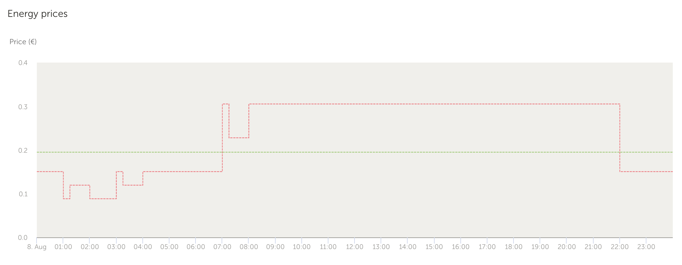

Then I noticed our location wasn’t set in VRM. So I did that but now curiously we have these grid buy prices that are all over the place and vary as I click tomorrow, next-day. I tried setting them and turning DESS off-and-on but seems a glitch?
I’d love to get this back as right now our battery is charging from daytime grid!
Thank you all - this is a really cool community and I’ve learned a lot from lurking here!
^ Somehow the system has decided these!
^ As configured ToU tariffs. Note I enter these in GMT despite my being in GMT+1 right now as I was having the battery charge wrong by 1 hour!

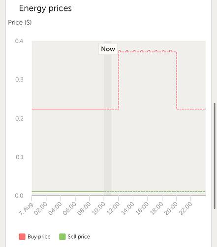

    You can see on my chart below the “peak” prices are oscillating up and down (between yesterday’s peak rate and today’s peak rate) but in reality the rate is fixed. Once the time actually passes, then the line becomes solid and at the correct price.
    @Barbara @jarco I’m guessing this is something you’re aware of, but it started occurring after the database outage a couple days back.

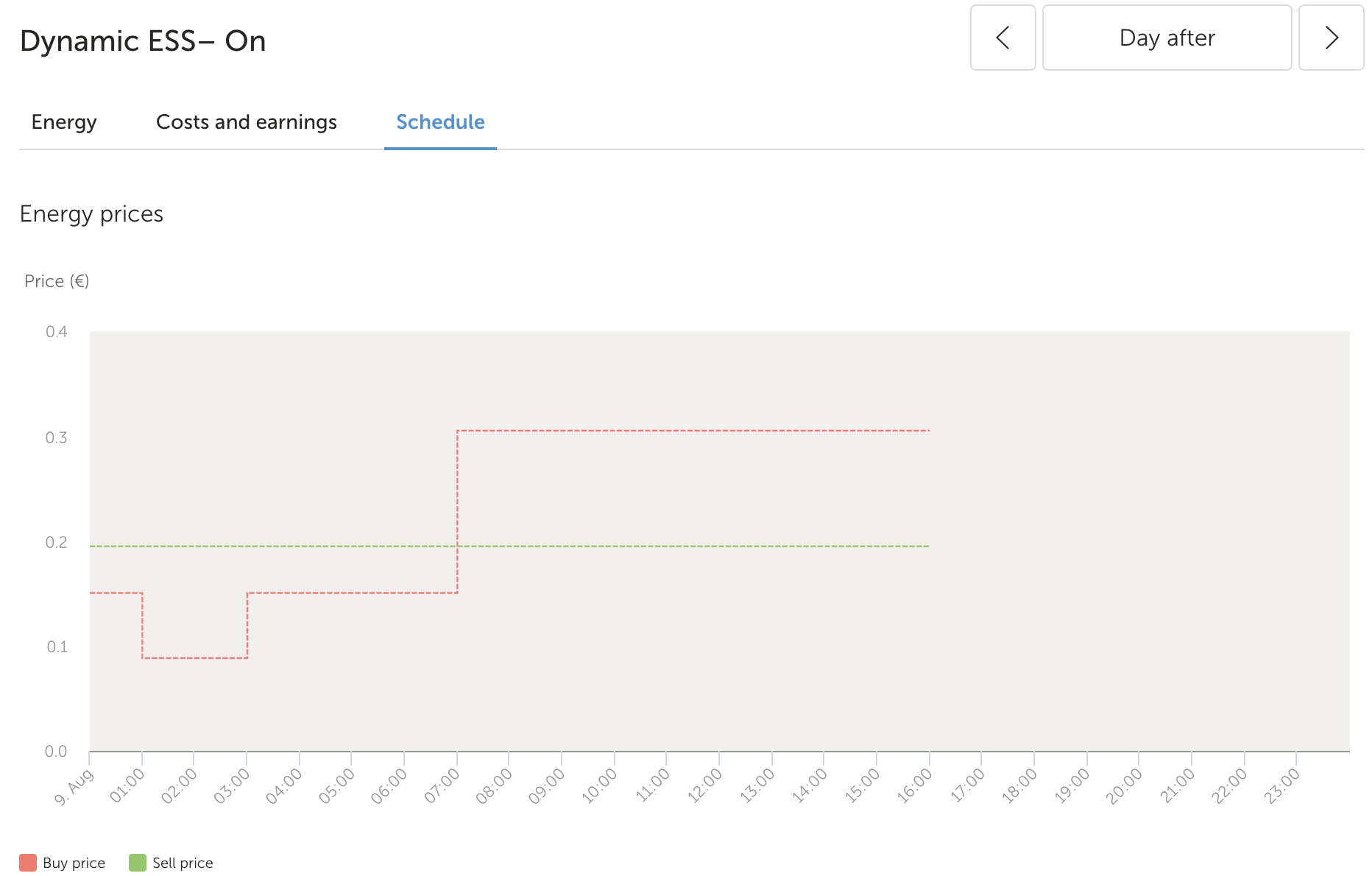

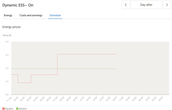

I think something might be settling down as tomorrow the tariffs are all a bit nuts, but the day after things start to look more sane:
This is looking much better; if the timeline is plotted in GMT and not localtime then this is correct up to the 1600.
(My tariff is Day: 0800-2300, Night: 2300-0800 with special “EV Rate” 0200-0400)
