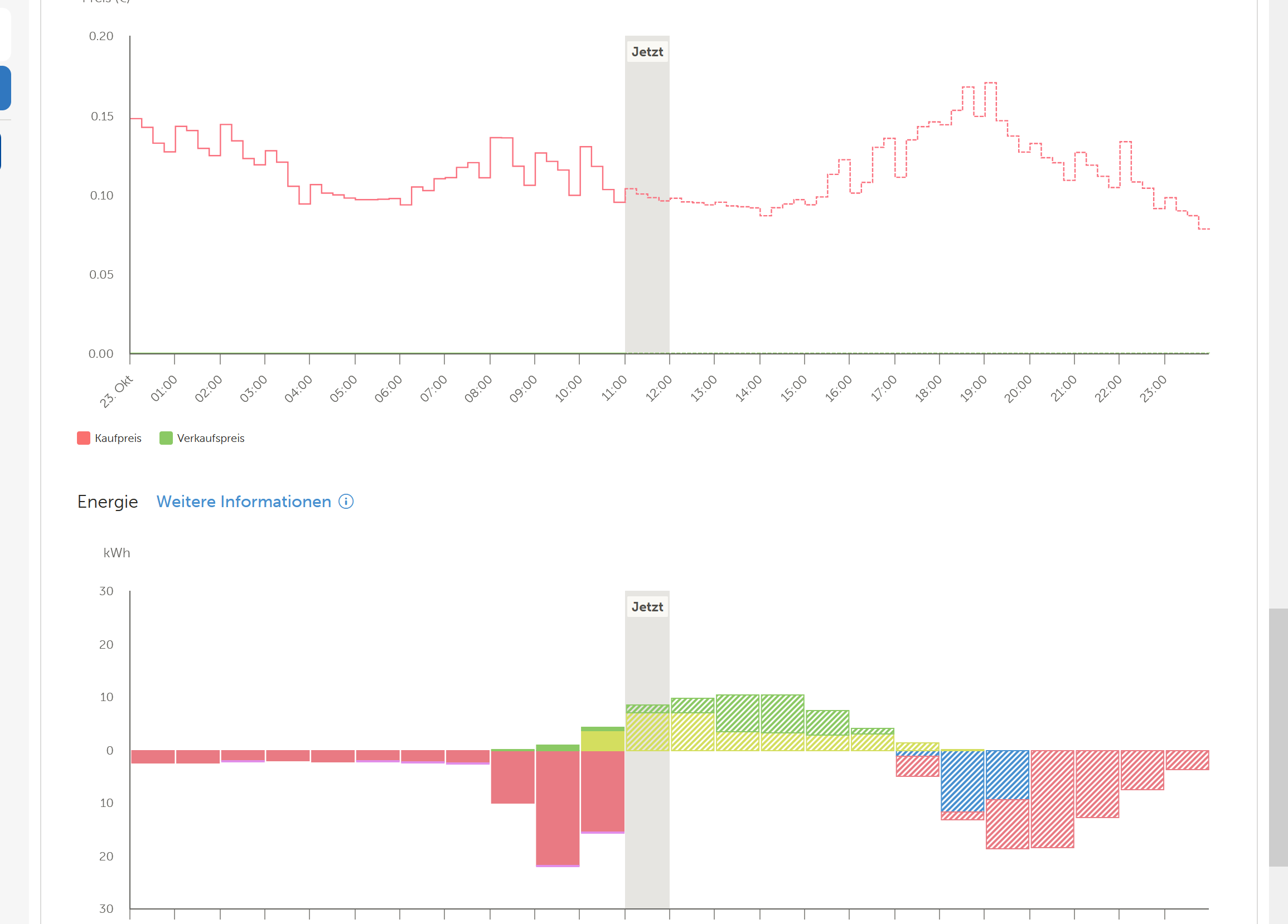

hello,
The prediction for tommorrow is finished and it doesnt make sense
I dont understand why the battery isnt gonna be charged with 1 cent price and the battery is gonna be empty

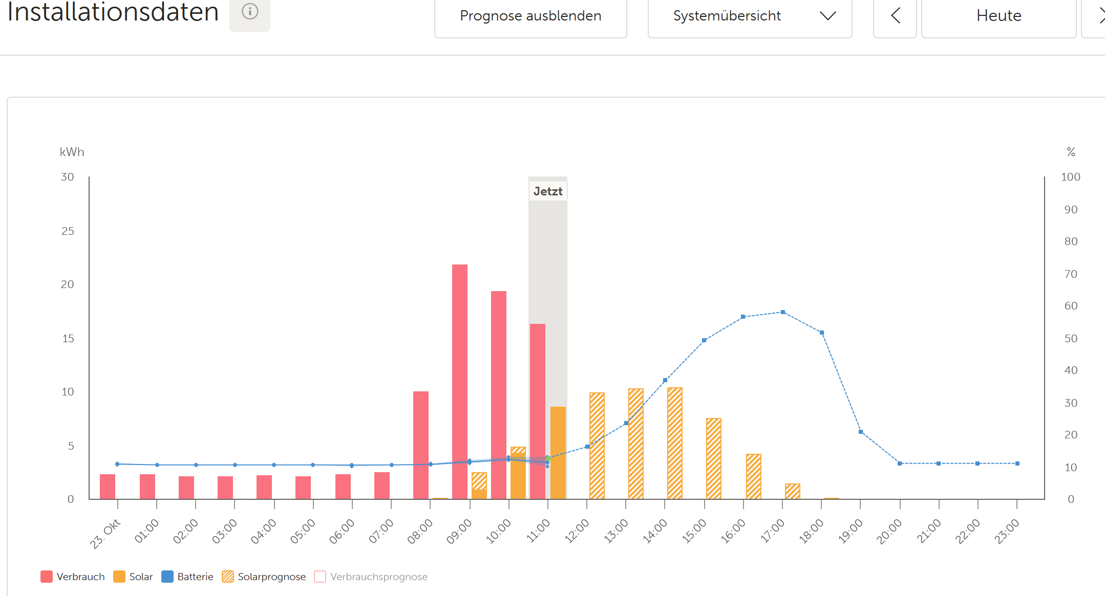

Please show the configuration of your DESS
you also always should show the forecast graph, e.g.:
