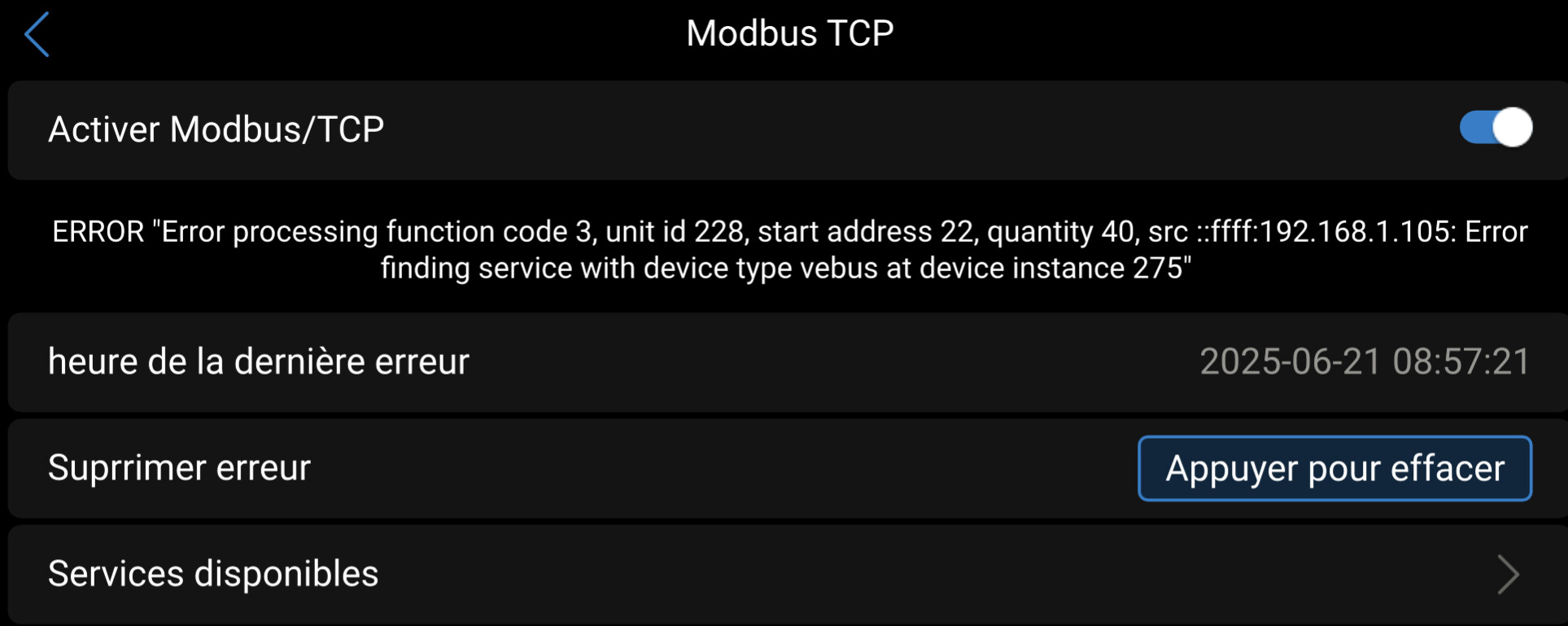

I found some errors in the protocol Modbus TCP, they appeared after changing from a Cerbo GX to an Ekrano. The IP addresses come from my EVCS (I have 2). It’s as if the EVCS were trying to communicate with the old instances (the instance numbers have changed following numerous hardware modifications on my installation). So my question is, how can I prevent EVCS from looking for the old instances? The easiest way would be to flash the EVCS with a firmware containing no parameters ? I have tried an update but the parameters remain.

Hello, I think the error time is constant but never stops. Attached is a video. The two IP addresses correspond to the two EVCS addresses.

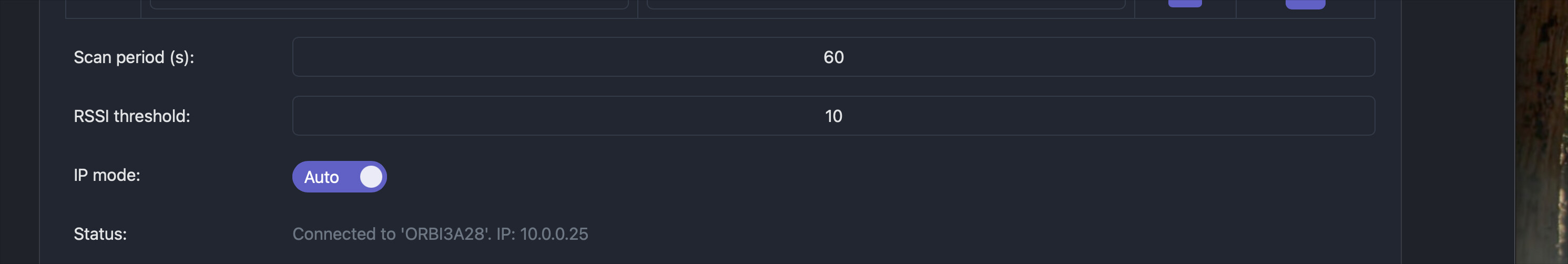

Both EVCSs are Wi-Fi enabled but can switch from one Wi-Fi hotspot to the other from time to time. The EVCSs operate normally despite this. I had to enable the Period Scna feature on the EVCSs to prevent them from randomly losing the GX connection to the Ekrano, but the errors were already present before activation.

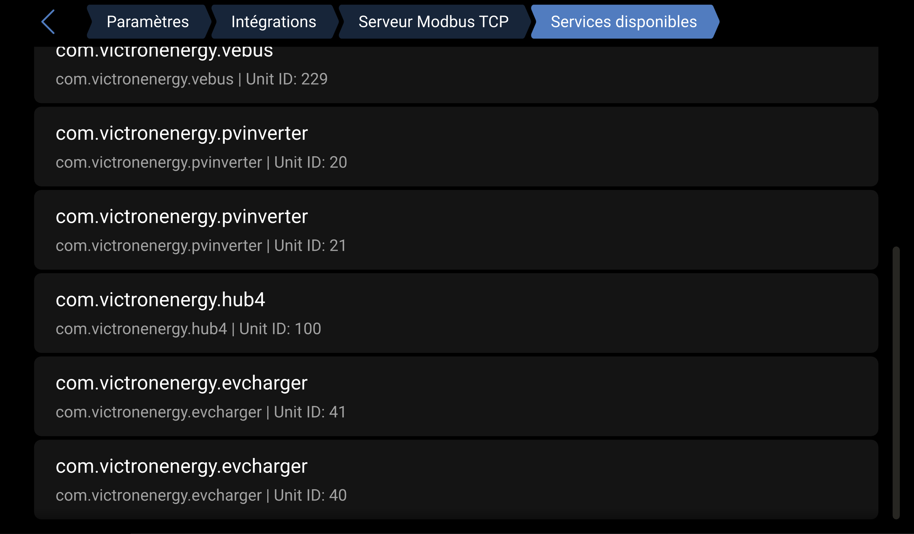

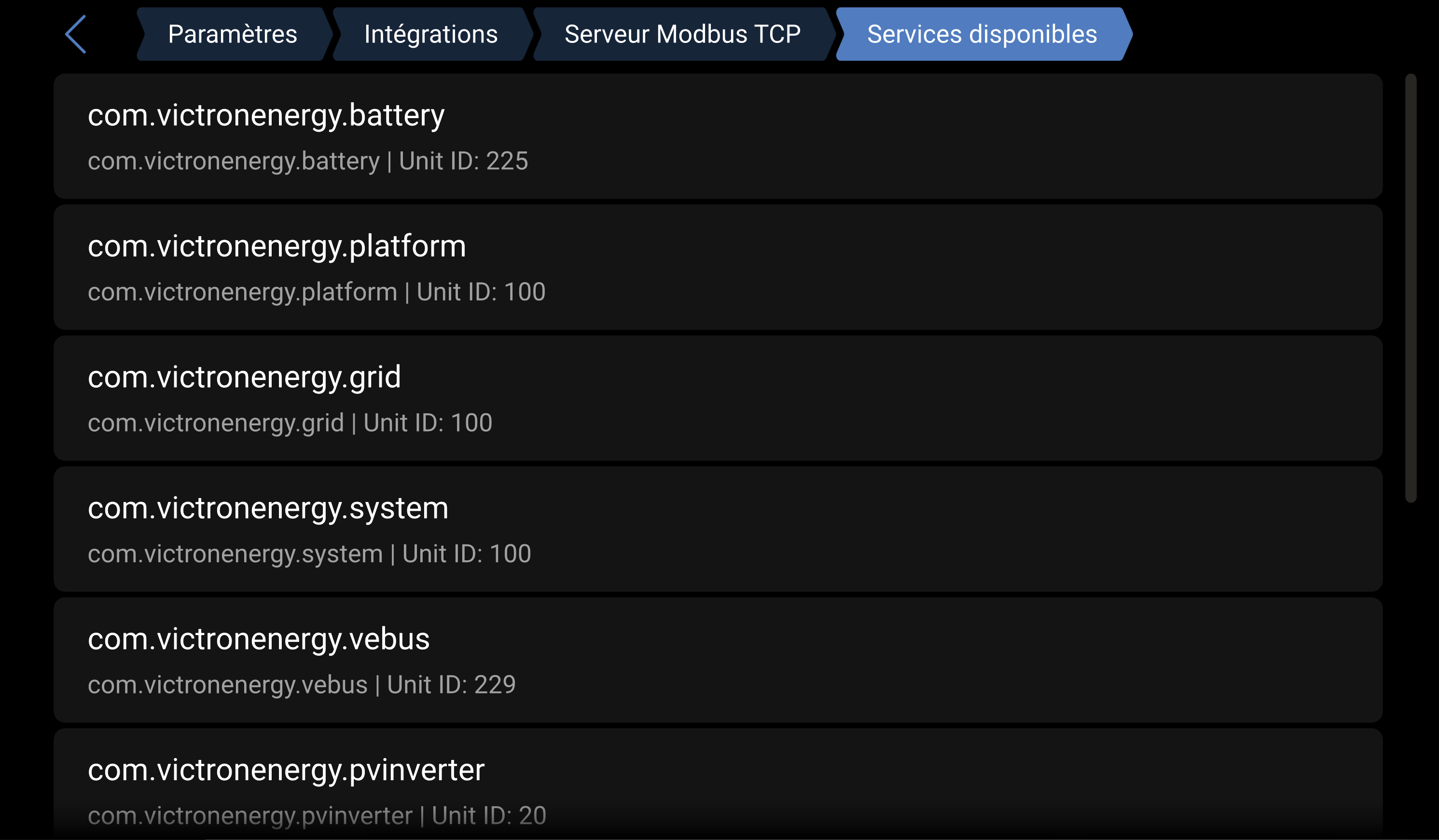

Ok. Can you please also provide a VRM instance number for both inverters? It should be in the device menu.
Hello, is this what you asked me? Thank you.
yeap
Yes, @Axelfolly it was useful. Improvements will be available in the next release.

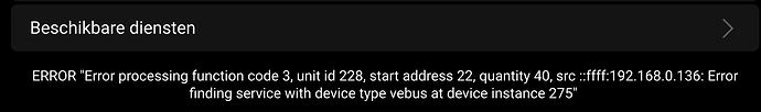

I have a the same fault.
FW EVC 2.0 - FW Cerbo 3.63
The message comes en goes ; I have a topic in Node Red aswell because the EVCS node shows ‘not connected’ from time to time.

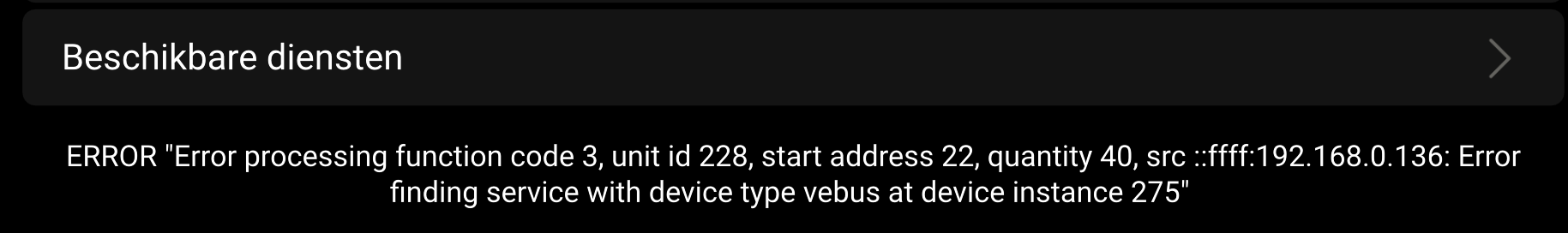

How to solve this as without connection Node red flow stops working and is rather crucial in the automation.
@Nicolas same problem here, the error comes and go making the NodeRed integration not reliable. I use it to stop charging after certain battery level, but now I have to manually check.
