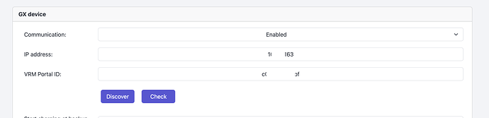

I’ve just installed the 22kw EVCS and for the life of me can’t get full communication happening between the EVCS and the Cerbo GX. I have the EVCS coming up on the VRM Portal, I can see the EVCS on the remote console, I can log into the EVCS console via both local IP and via VRM, I can see the EVCS on VictronConnect, HOWEVER no network data comes up on the EVCS, and when I run a check on the GX devise page of the EVCS, I get “Can’t connect to the GX device (192.168.0.71)!” I’ve double and triple checked the IP address and VRM Portal ID entries in the EVCS “GX Devise” page, they are correct, it even finds the Cerbo via the discover button, and Modbus is activated.

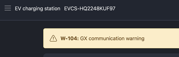

I’ve done all the basic stuff - firmware is the latest on all components, definitely all on the same network, rebooted everything in every different order I can imagine…but I am stuck with W-104 GX communication warning, and no network data on the EVCS. What have I missed?

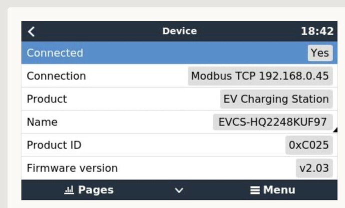

What I find puzzling is that when you view the EVCS via VRM portal on the devise list on the GX, it says connected (see screenshot). The problem seems to be a one way issue…the GX can read the EVCS data, but the EVCS cannot read the GX data…???
Screenshot from the GX:

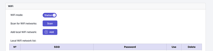

Stupid question. Is the EVCS in “station” mode for the network and is it connected to the same Wi-Fi SSID as the Cerbo?
Also look at the three attached screenshots. Try entering the Cerbo GX’s IP address in the whitelist on the station (see screenshot).
Yes, EVCS is in “Station” mode, and is connected to the same LAN network, although the Cerbo GX is connected to the network via LAN, not Wifi. Wifi is disabled on the Cerbo GX. It is definitely the same DHCP network though, and the EVCS finds the Cerbo successfully using the GX Device “discover” button. Also have added the GX IP address to the whitelist in the EVCS, but I still get the same “Can’t connect to the GX device (192.168.0.71)!” message when using the “Check” button on the EVCS.

Full hard reset via 15+ second DEF button press (confirmed with 3x blue flashes of the LED ring) complete, first setup run again. No change. Cerbo GX shows the EVCS is connected via Modbus, but the EVCS says W-104 GX Communication warning, and does not display any network data.
Ok…I’ve made some progress. I stumbled across the services page in the Cerbo GX, and there is a “Enable/Disable Modbus TCP” button. It was Disabled by default. I enabled it, and WALLAH! the W-104 error has gone away on the EVCS and it is now displaying data .

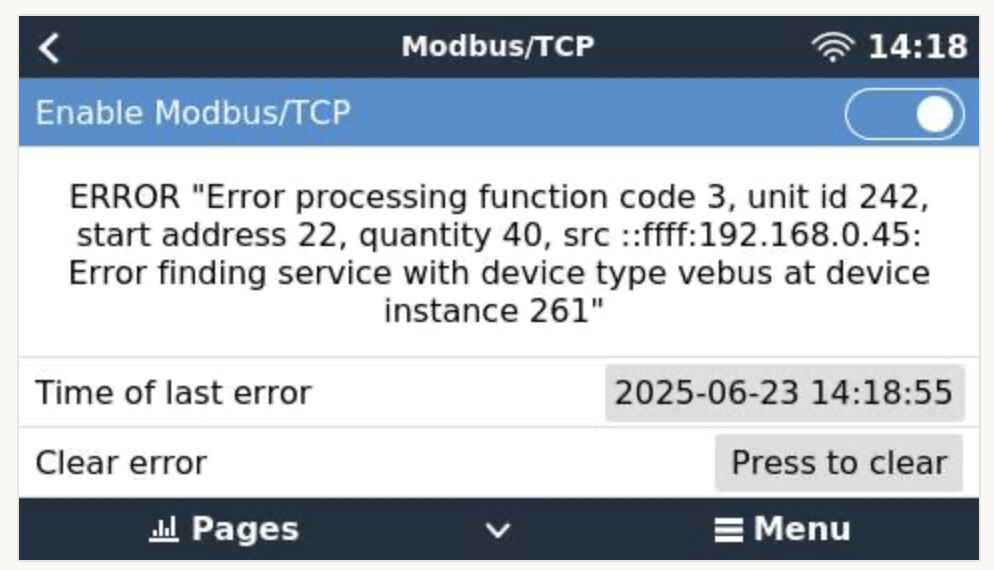

There is now however, a continuous error in the Modbus TCP area of the Cerbo GX (see screenshot below) but I have not found anything affected by it on the network.

Hello, yes, you need to enable Modbus on both devices. I think I noted it above. The main thing is that it is resolved. For errors in the Modbus, don’t pay attention to them for the moment. Many of us have them without it affecting operation. However, for a mesh network, it is essential to enable periodic scanning to avoid dropping the WiFi. In Victron Connect and network settings. Another thing in Victron Connect, the EVCS only appear locally. You can have some commands in the remote console on VRM in the device list section. Here you go
