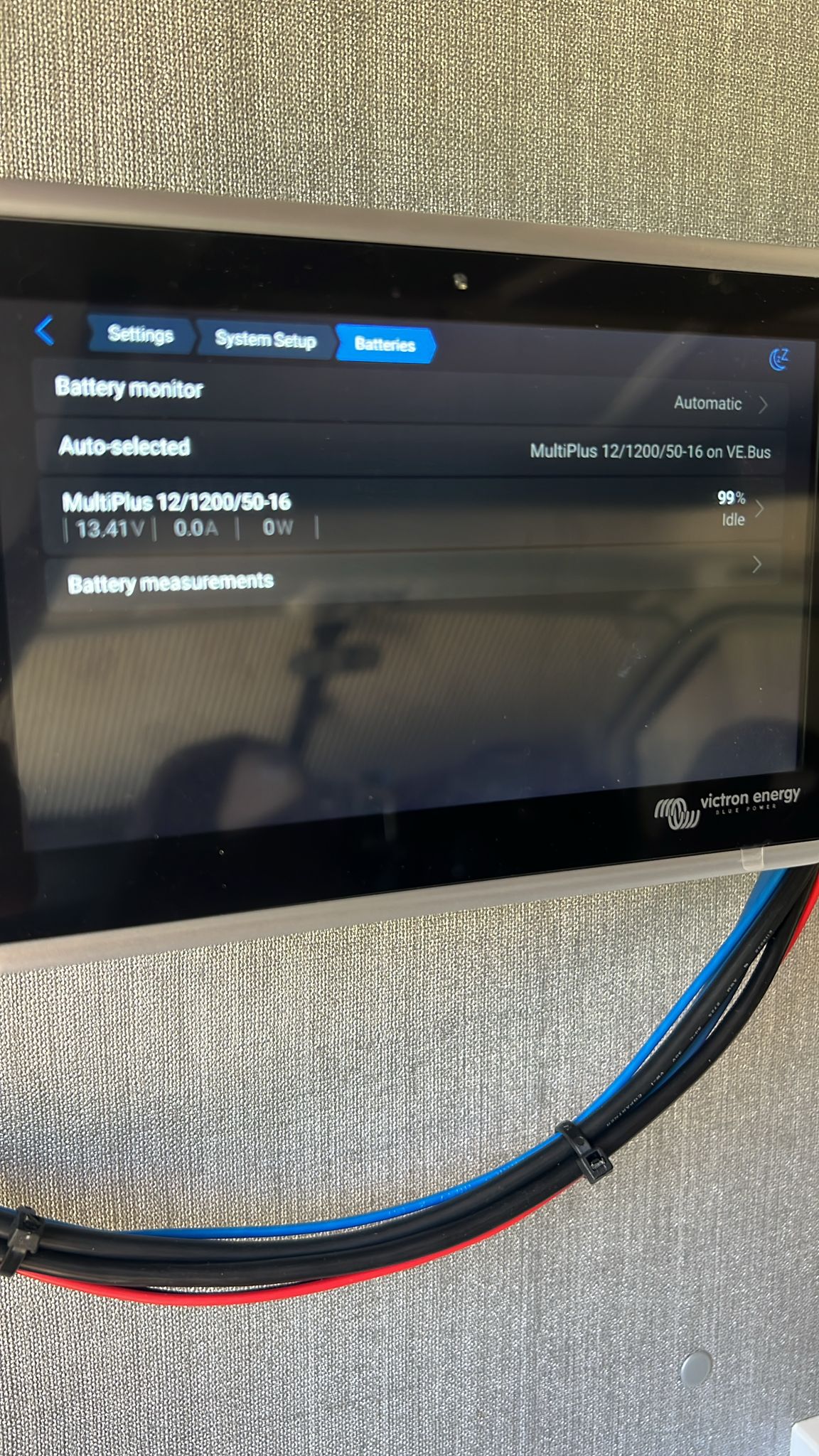

The BMS that is installed is the Victron VE.Bus BMS NG and connected to the Multiplus with the ethernet cable and the Ekrano is connected to the Remote panel output.
The is no option available in the settings/system setup/batteries to see the NG battery directly. Only with the Multiplus you can see the battery info. This info is also not the same as you can see with the bluetooth Victron app.
I am familiar with the Lynx withh all NG battety info. The VE Bus BMS appears more limited.

Also in Node Red I can not find any parameters from the NG battery, I hope they will add this function later!
