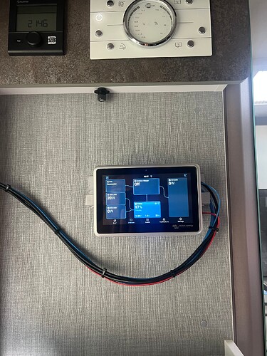

The Ekrano panel will replace in the future the panel from Burstner, if I have found a solution for the tank sensors and the voltage read out of the starter battery.

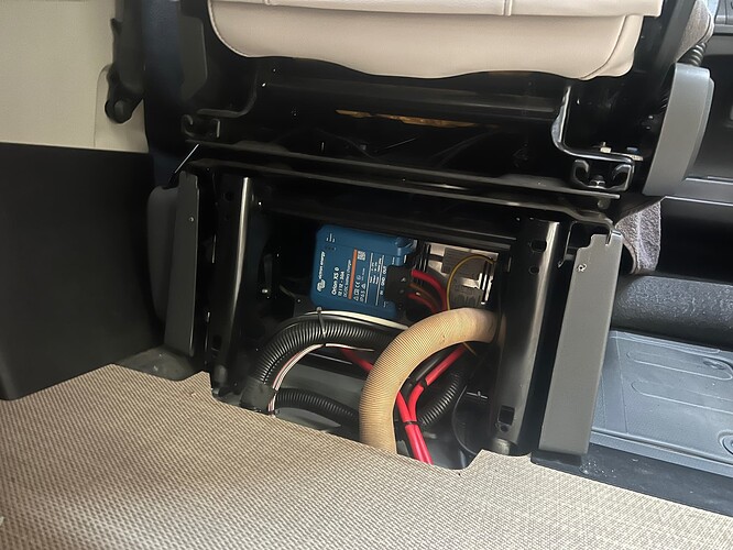

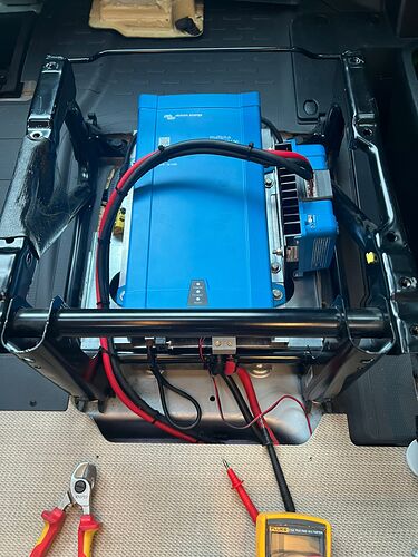

Under the passenger seat I have placed the charger/inverter and solar charger.

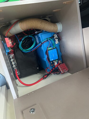

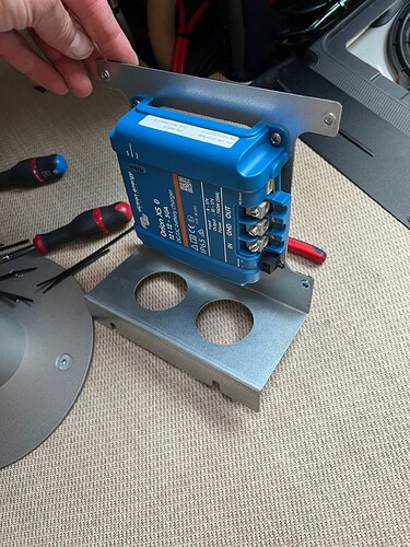

Under the driver seat there is the existing EBL (12Vdc distribution box) with the Orion XS.
I love the options that are available, first I have tried the Raspberry Pi (what also is a really nice feature!!) but with all the vibrations in the RV I purchased a Ekrano panel.
