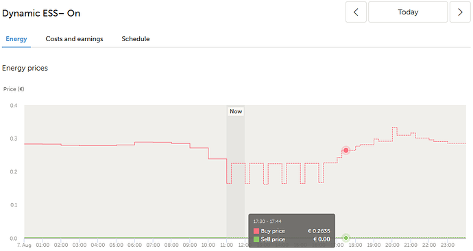

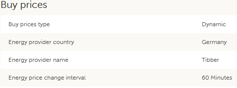

Since (at least) yesterday VRM is showing 15 minutes buying prices for tibber Germany, although my setting is:
I don’t see if they are really used for calculation, but this is confusing…

You may be experiencing a similar issue as here: DESS - added location and my Fixed ToU grid prices became variable?
I believe there’s a recent bug in VRM. I have a simple peak / off-peak pricing scheme, with daily variable peak pricing – yet DESS is showing oscillation in my peak prices (starting a couple days ago).
This appears to have been an error; it was corrected yesterday for the hours in past.
Today everything is OK, variable prices on an hourly basis.
