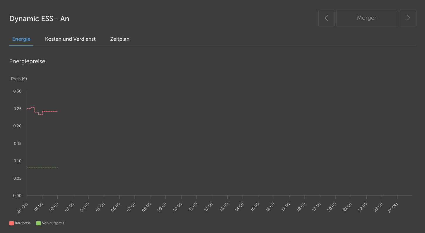

Not sure what’s wrong here but DESS reactive strategy is NO_WINDOW since 13:00 today and on VRM the prices for tomorrow are shown until 2:00 am only instead of the whole day. My Tibber app shows correct prices for tomorrow.
Same here
Maybe related: tonight we daylight-saving related time switch from CEST to CET
Happens exactly at 2:00…

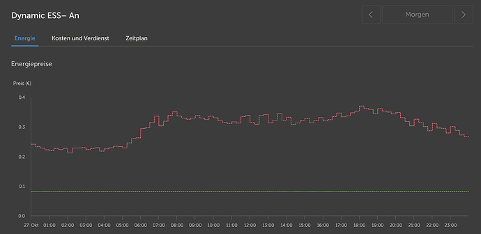

It works again ![]()
…and it’s even forecasting the prices +schedule of tomorrow - which I like very much:
