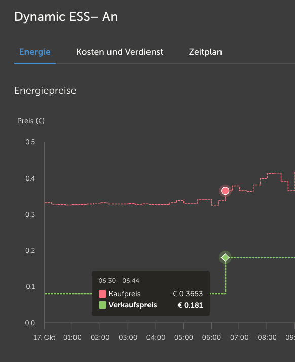

Looks like VRM DESS shows prices with incorrect timings. Perhaps DESS also plans incorrectly because of this?

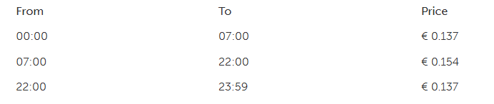

Here are my DESS buy price settings:
VRM renders them changing at 6:30 and 21:30.
This problem exists in the betavrm as well.
I added a DESS charging restriction from 21-22 to temporarily avoid the issue.
Since yesterday i am searching for daily cost/earnings differences between DESS and my energy supplier. Before that time it was almost exactly the same every day.
Maybe this is related to this topic. At first i thought vrm was calculating with hour average instead of 15min prices. But when there is a time offset it also calculates wrong. But is does plan perfectly on 15min.
