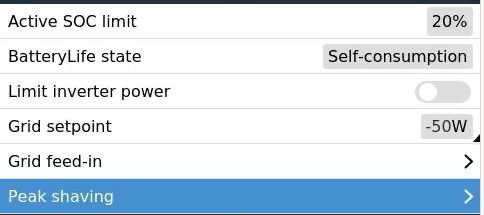

What are the ess battery settings?
Optimized (with BatteryLife)

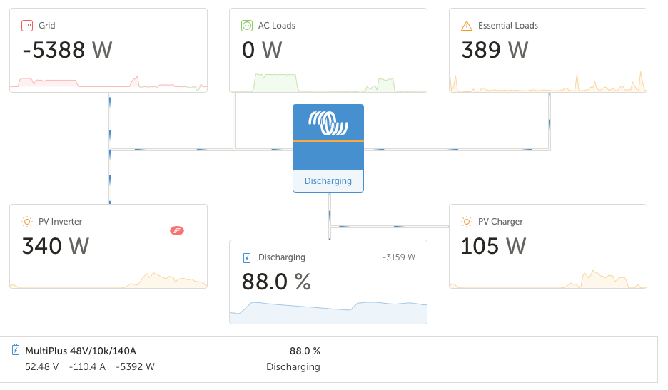

for the record, a screen shot of the discharge happening on the batteries, with no solar power and DC feed in option enabled

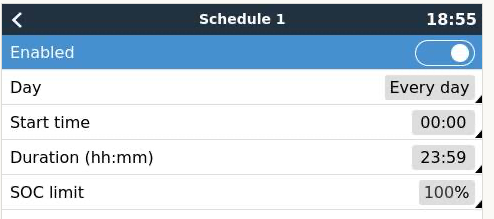

I tried it with these options which should guarantee charging batteries is always priority… not working

I how we have set up the charging is to bump up the min soc stepping up during various hours during the day so we can end with a full battery. It may be better to do that rather than have 20% min soc then one other setting saying you always want 100%. It is a bit conflicting.
