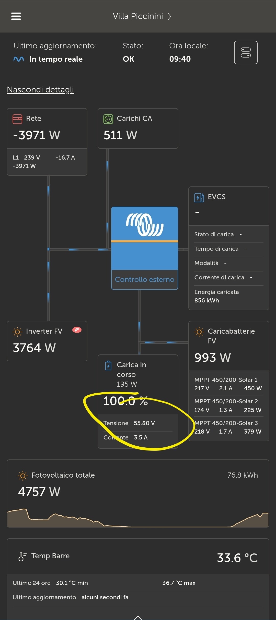

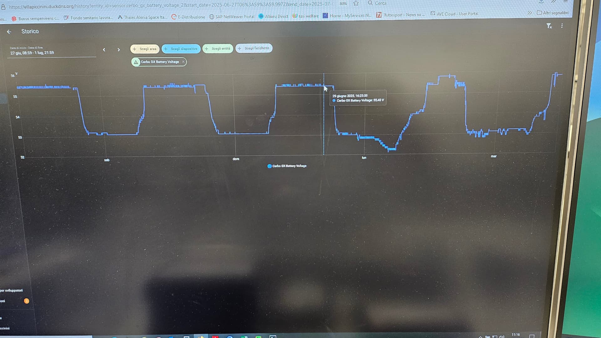

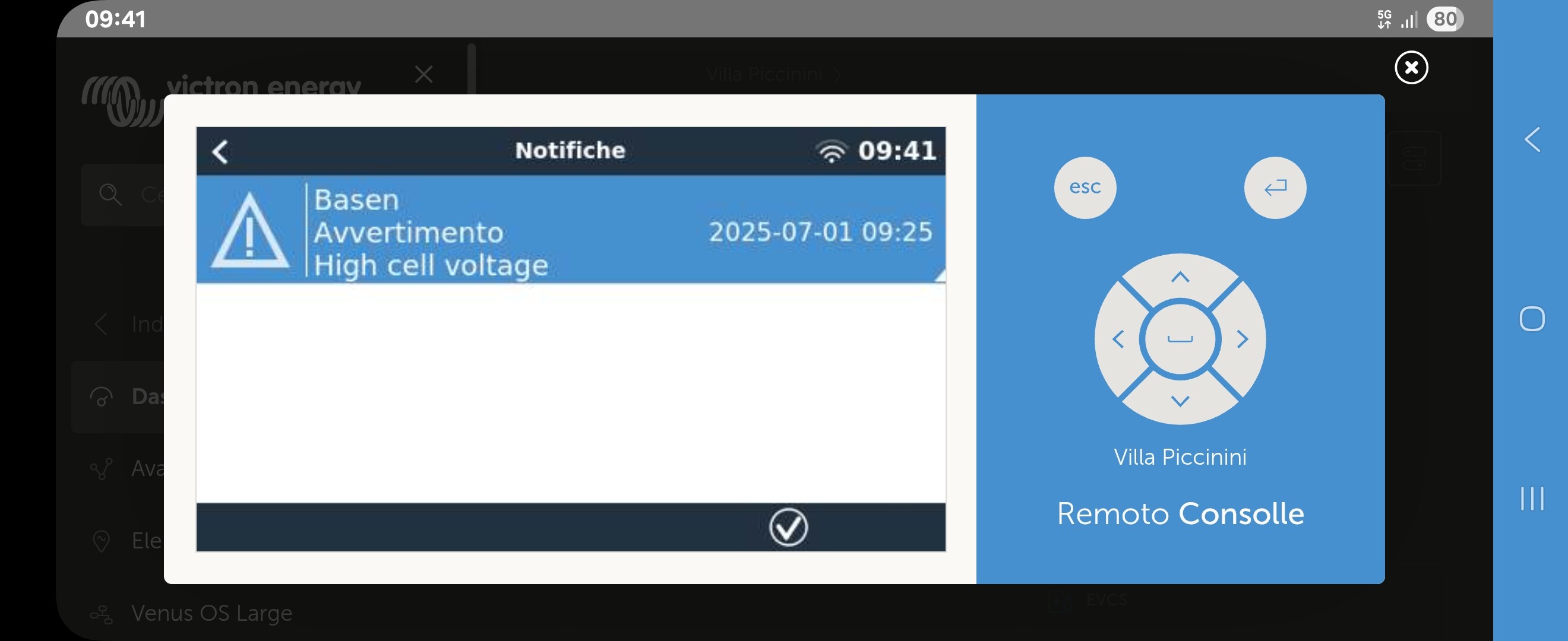

Hello, I need some help I hope you can help me. I need to put the photovoltaic excess on the network for a maximum of 4500w, at the time when victron feeds into the network the battery voltage fixed at 55.4, rises to 55.8 . how can I avoid this rise?
Did you already try to limit the charge voltage via DVCC settings?
