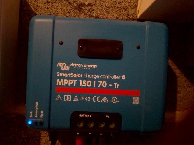

And the charging voltages should be checked. There is a very high probability that the voltages are set too high and the absorption time is too long. Which charge controllers are being used? Is a temperature sensor attached to one of the batteries?

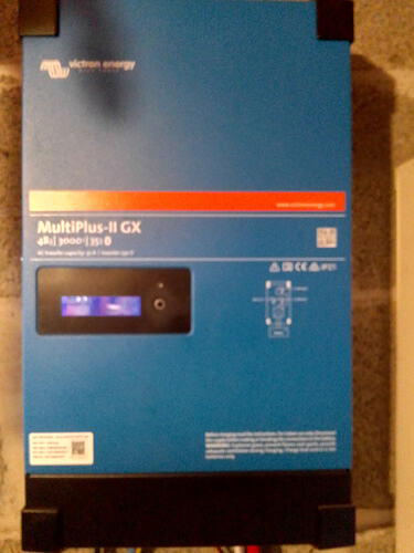

  • the MultiPlus central system
  • the charge controller

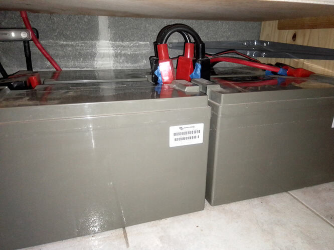

  • an overview of the 4 batteries (showing that they are connected in series)

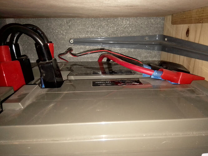

  • a close-up of the two batteries on the right

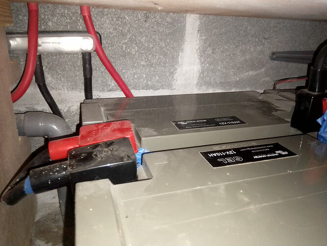

  • a close-up of the two batteries on the left (the one at the back is slightly swollen and hotter)

Since the batteries are connected in series … unlike assumed above … you obviously can’t simply “remove” one battery.
The damage pattern is typical of AGM batteries that have been operated without a balancer. Chemically, all batteries are slightly different, and eventually one battery ends up receiving too much charging voltage and “boils dry”. The cells swell up, and then you get a result like the one you have. At least a temperature sensor was installed … it may have prevented the worst by adjusting the charging curve … :sweat_smile:

Okay, that was a 48 V system made up of Victron batteries. It’s a shame you didn’t install three balancers there; they would have helped keep things balanced. Battery Balancer | Victron Energy
As it was, the slightly different cell chemistry caused one block to drift out of balance, which boiled the cell dry.

You have a MultiPlus 2 “GX”, which means that a GX control unit comparable to the Cerbo GX is already built in.
You can connect it to the local network and also link it to Victron Remote Monitoring (VRM). You can see a great deal of information in VRM.
