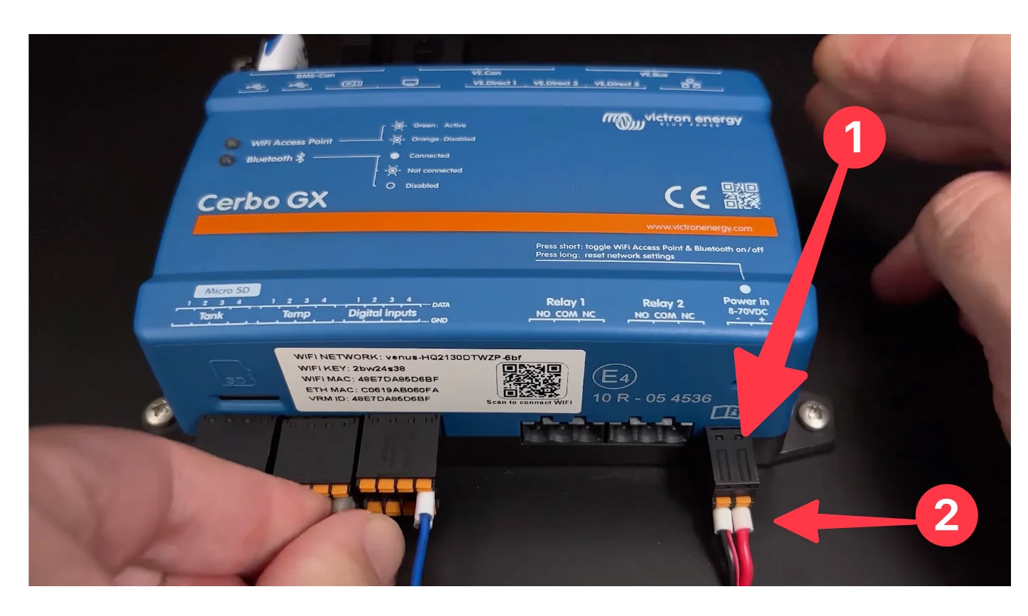

Using it on 12v , the input is ok , but no lights in the cerbo
I read ther is internal fuse, where is located?

@dan100 The Cerbo should have been fitted with an external inline fuse, which GX devices / Cerbos are supplied with.
Please measure the voltage at the input terminals.

Did you measure 12V (8-70vV) on the input terminals?

If you measure 12V at the pins and nothing happens, it seams that the cerbo gx is broken. Polarity is correct?
If you are operating the Cerbo with an external 12 V power supply rather than direct from a battery, I would recommend replacing the power supply again to test it. It is possible that the external power supply is defective rather than the Cerbo. I have encountered this exact situation before.
