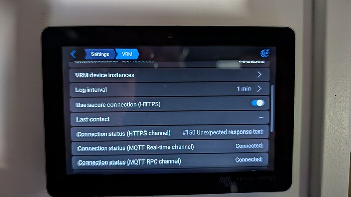

Just ran into this with an installation which hasn’t had a real problem in months. The one thing that changed is that the Cerbo was disconnected from the Internet for a day, so began buffering updates (currently about 1000 stored records). The installation is a work in progress, so things have been rebooted, short network interruptions, etc., but not for more than a few minutes until this.
VRM realtime works, but there’s a blank area in Advanced graphs because updates aren’t being sent. MQTT Real-time channel and RPC channel both show connected. I’ve toggled “Use secure connection (HTTPS)” and after a few seconds either setting results in the same #150 error.
Running 3.70~95. Went back to release 3.67 (downloading firmware still works), which has exactly the same issue.
Edit: curiouser and curiouser. After sitting a while longer, it’s now connected and I watched stored records go to 0 (happened to catch it when just a few were left). VRM graphs filled in. But then Remote Console disappeared in VRM. A few minutes later, after a page refresh, and it reappeared and loads fine. I can only guess that the #150 error is misleading, and really indicates some sort of throttling mechanism when stored records are being sent. Or not.
