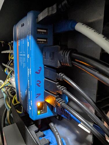

For quite some time now [about once a month over the last 2 years, and almost 3–5 times a day over the last 3 months], my Cebro GX running firmware 3.75 has been losing its connection to the LAN/VRM portal. I connected a laptop to the cable and ran a continuous ping for 2 hours with 0% packet loss, so the line itself seems to be working. While the pings were running, I also connected the Cebro once, but it was unable to establish a connection.
What I find very strange is that, even though no LAN cable is connected to the Cebro, both LEDs are lit—is that really normal? The LEDs do go out “at some point”, but when I plug in a cable, they often stay off…

I will add, as a complete aside, that you have a VE.Can terminator in the spare VE.Bus port. Remove that; as detailed in the user and installation manual, VE.Can terminators are only to be used in VE.Can ports.
Do you mean this one?
Yes! That’s a VE.Bus port, and must not have a VE.Can terminator in it. I don’t think that’s what’s causing your specific issue, but it can certainly cause issues in general, thus the warning in the manual.
With regard to your issue, I’d suggest taking the Cerbo out for a bit and double-checking the pins in the Ethernet port; hard to zoom in far enough, but those pins look a little funky, it’s possible that some corrosion or bent/crossed over pins or something could be causing the port to think something’s plugged into it.
The termination resistor belongs in the 2nd BMS-CAN port, not in the VE.BUS
port.

And just to be safe: the resistor then needs to go “above, underneath the blue cable”, right?

Yes, exactly—that’s where the terminating resistor belongs.
However, as already mentioned, that won’t solve the problem with the illuminated lights.

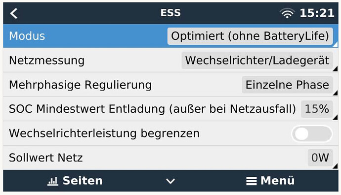

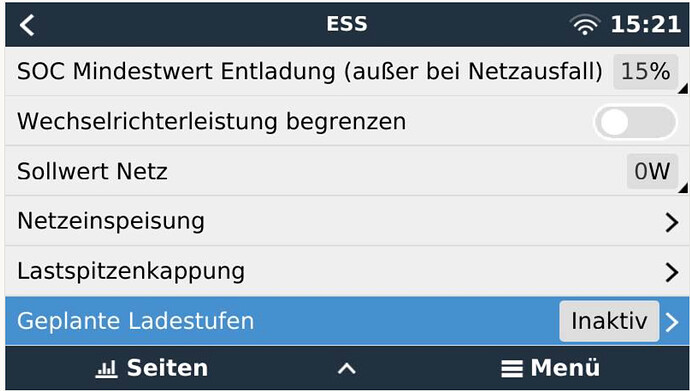

Have a look on the remote console under → Settings → Devices and post a picture of it
then one of
→ Settings → System Setup → ESS
Is there no documentation for the system?

Screenshots attached.
There’s no documentation, and the warranty should still be valid. I had the system switched off for 8 hours, but unfortunately that didn’t help :wink: Ethernet now shows as connected, even when the cable is unplugged… Refreshing the window doesn’t change anything either, and the LEDs are lit. I’ve tried cleaning the port…

You have a three-phase grid and ONE MultiPlus 48/5000?
Do you know how the MultiPlus is connected? AC In only, or AC Out as well?
As far as I know, the system can’t work like this because the three-phase grid meter is missing…
