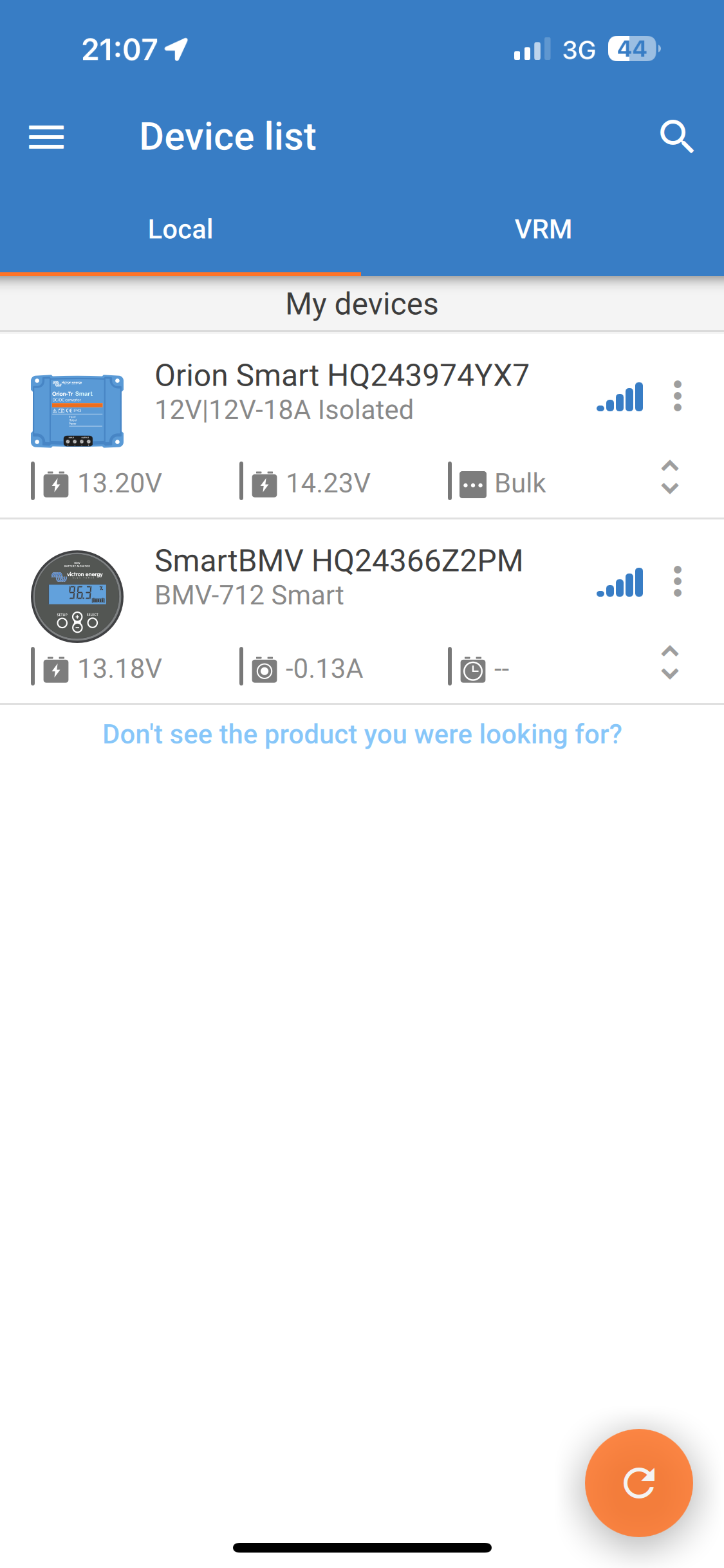

Hello. Fitter the Orion Smart DC-DC charger today. Initially it showed x amount of amps on the BMV712 but not it shows nothing is going in through the shunt? It’s wired as diagram so not sure why it doesn’t show anymore. The charge says bulk charge and has output of 13.2V

Just taken to local company. All wired correctly. They will bench test it for me to confirm a faulty unit
Bench test confirmed faulty unit out of the box. Replacement has been sent out
