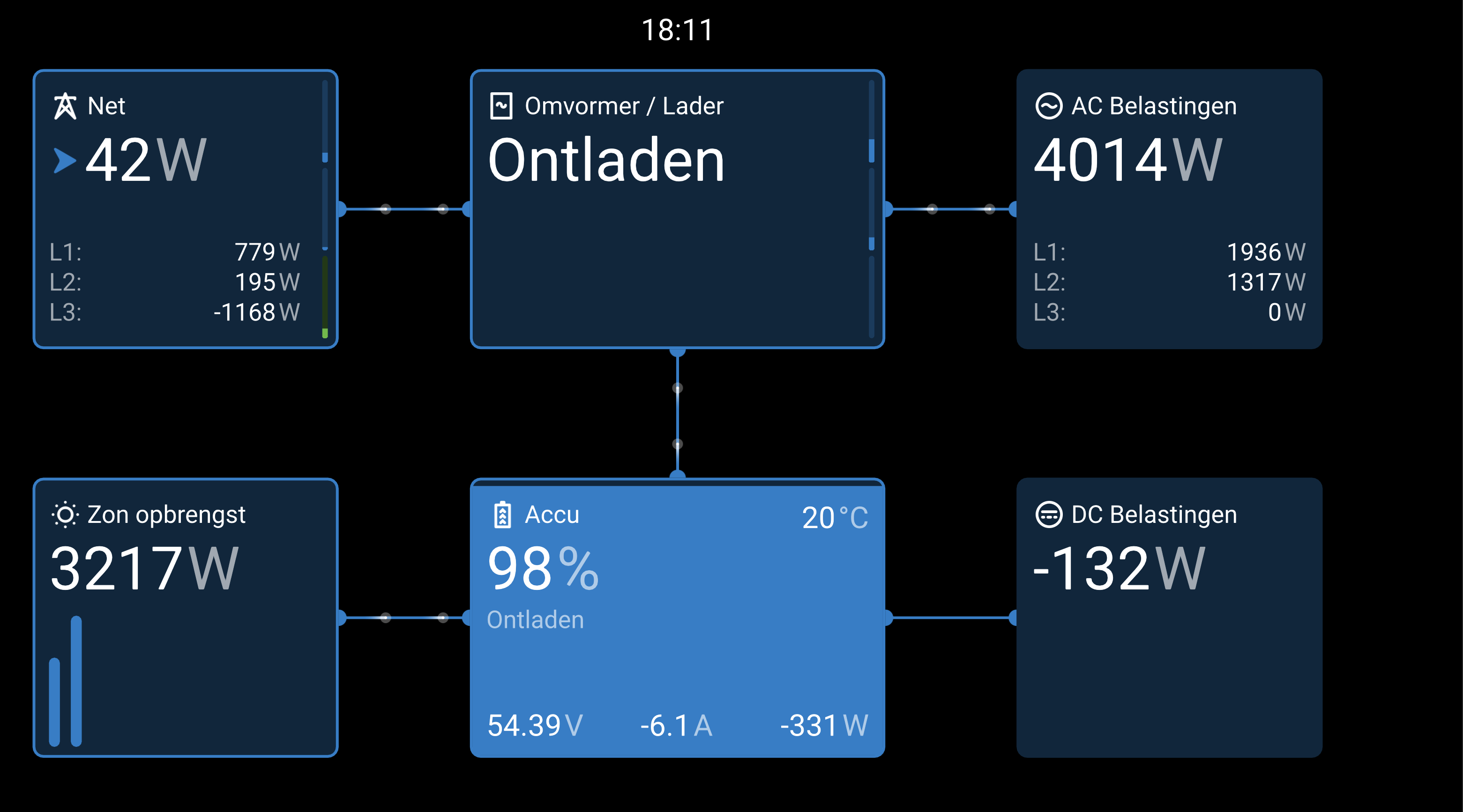

Load balancing has proven difficult. While the base load is relatively even across the phases, high-demand scenarios—such as using the oven with light house loads, running the induction cooktop while the EV is charging, or operating the dishwasher and washing machine at the same time—frequently trigger overload warnings on one phase, while the other two remain underutilized.

And I still have the third MP2, so, the parallel setup is a good enough solution. I have still both clamps on AC out and once in a while I have a look at it. They are dead balanced :slight_smile:
