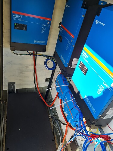

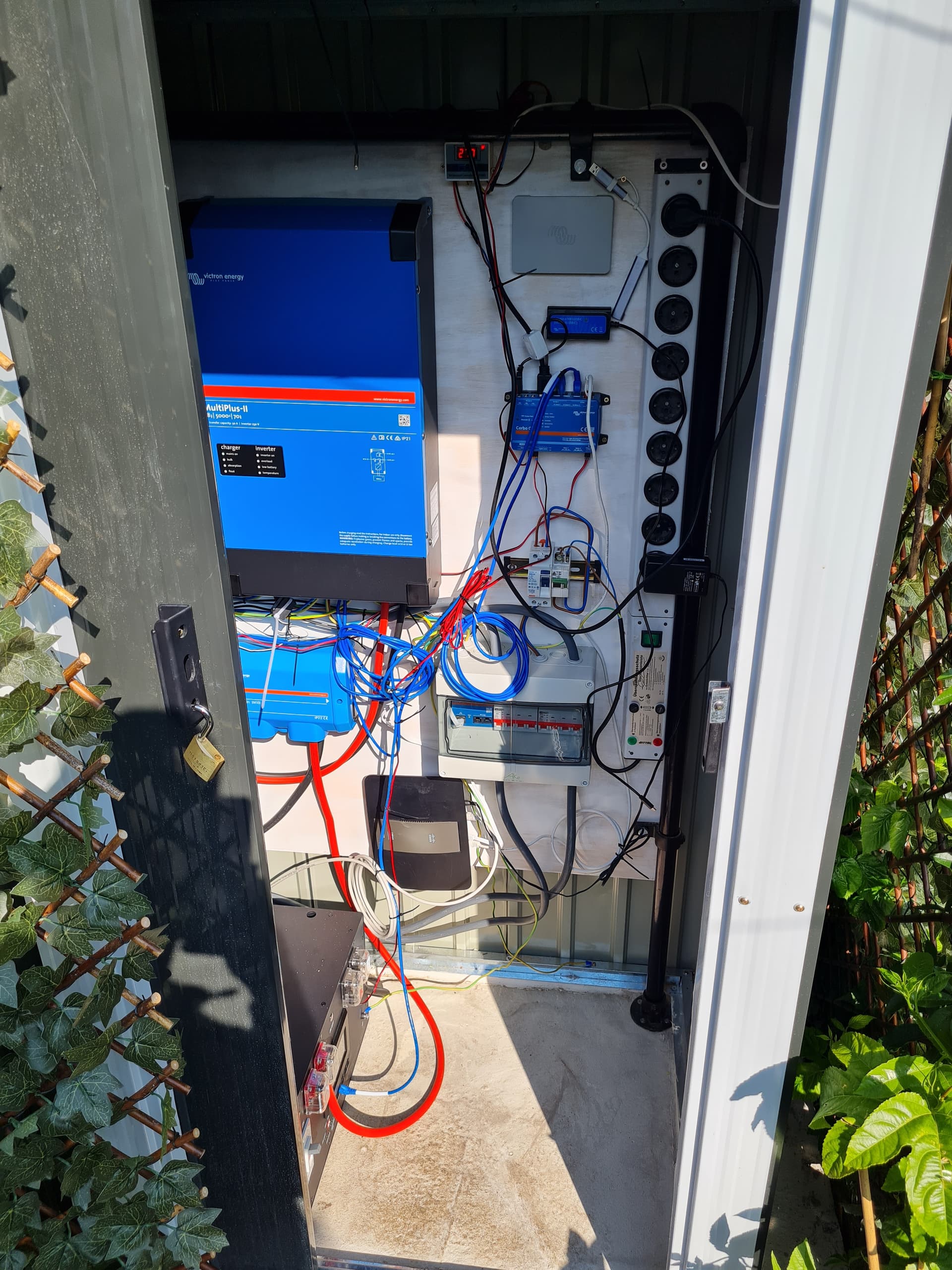

i am new to a victron system. my system works on 3 phases together with dess. a 16 kwh battery is connected to it. now i have the problem that the battery pack indicates a different percentage than the cerbo gx. and my multiplus on phase 1 gives low battery error code when it gets below 85%. how can i solve this. below you see the link of the battery pack.

the system is as follows from the main connection go 3 phases to the ac in of 3 multiplus 2 5000va. all load are connected to ac out 1. the multiplus are interconnected by ve bus and connected to the cerbo gx. a 5 inch screen hangs on the cerbo. a distributor is connected to the dc of the multiplus, the battery box is also connected to this, this battery box is connected via can bus to the cerbo
