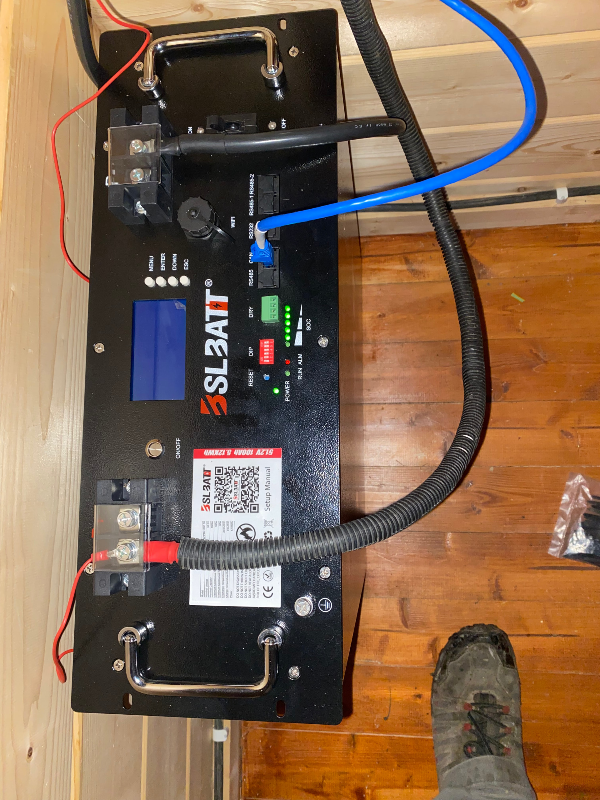

Anyway it’s stopped working with a “Low Battery” warning on the Multiplus. Battery has 5 ot the 6 SOC lights illuminated and the touch screen display shows battery at 83% and 50.4V. Done everything I can but it just won’t work. Contacted supplier but he’s very hard to get hold of for help.

Hi ! As most BMS the SOC and LEDs are very inaccurate. At 50.4 volt the battery is nearly empty (for a 16 s pack). You have to recharge it via grid to 100 % (with the correct charger settings). Maybe your mate did not charge the battery to real 100% for a very long time ? Maybe the bms had no chance to balance the cells too. The pack should be charged to 56 volt and stay there for a longer period of time to balance.

the problem is, that most bms are not able to detect very low current …. e.g. standy current of the inverters. This currents accumulate over time. Because of this the bms tells 82% while in reality the battery is empty. Charging to real 100% recalibrates the bms and everything is fine for the next week.

  4. You mention that you have a shunt but I see in the pic CAN also connected (I don’t use any shunt). So what is selected as the battery monitor in the Cerbo? A shunt may need initial calibration with the battery (if it is the battery monitor).
