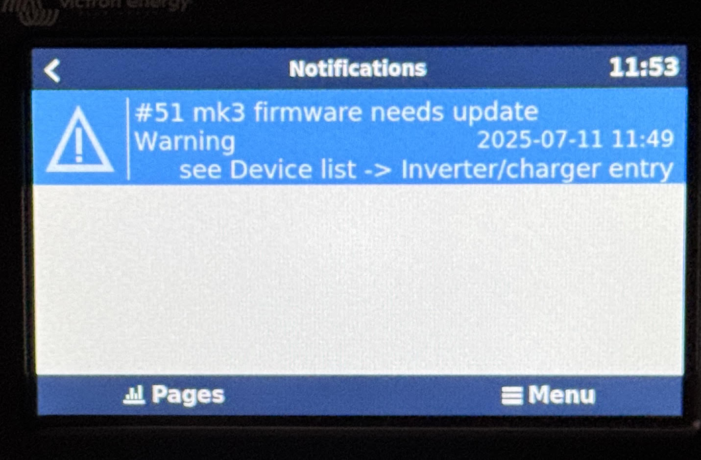

I have a Victron setup in my RV: Multiplus 2, SmartBMV, two Smartsolar controllers and Color Control GX. I just finished updating the firmware on the solar units and BMV. I also updated the firmware on the CCGX. The firmware on the GX went from 2.18 → 3.62
Now I see this notification: #51 mk3 firmware needs update
Is it important? If so, I do I resolve it?

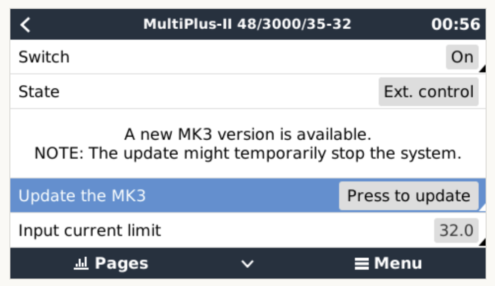

CCGX → device list → there should be the MultiPlus → click on the MultiPlus → there should be an option to update the MK3
Maybe add some more screenshots.

It doesn’t matter which VE.Bus device you have, that’s not an update for the MultiPlus it’s an update for the internal MK3 interface of the CCGX.
The menu should look like this:

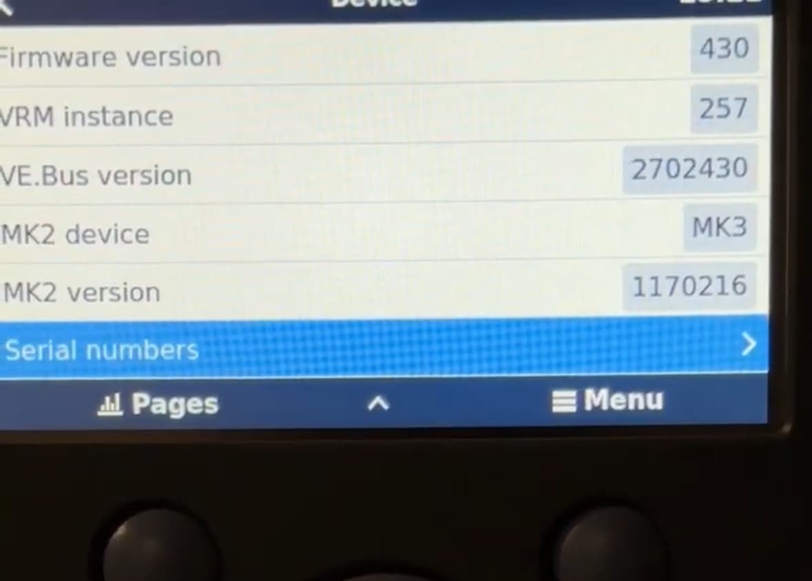

Here is a link to a poor video of me clicking through the CCGX menus: Device list → MultiPlus →

@Snowdog , thanks for the video - that helps! The version shown in the video is v216. (the last three digits in 1170216 indicate the version).
And that already is the last version.
This is a still from the video:
