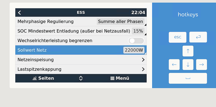

Try sometime to see what happens if you leave Modbus control off while charging the EV, and simply set a setpoint of 22000 in the ESS settings in GX.
That way, you can see whether it generally gets stuck, or only when using Modbus.

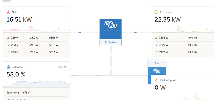

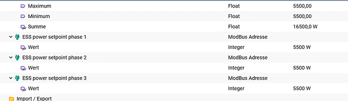

Yes, I tried that. Modbus must no longer send the setpoint, so I set it to Manual in the panel instead… This is the result
So 5500 definitely seems like a threshold value to me. If it were a conversion from a current limit value, it wouldn’t be “such a nice round number”…
But with 3 MP 3000, I can’t see anything that fits, either for 5500 or 16500.
I can’t figure it out either; there’s nothing relevant in the search results. Maybe I’m also one of the few with a 22 kW charger, which lets me push the system this hard. Most people with 11 kW can’t get anywhere near these figures.

checking the mqtt paths, my single phase system is:
N/dxxxxxxxxxxx/vebus/276/Hub4/L1/AcPowerSetpoint
The other phases are L2, L3.
I set it via ESS settings tab on the GX to 20kW and it ramped to that setting, took a number of seconds.
