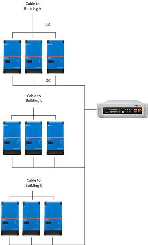

Hi. Your post is confusing. Maybe something lost in translation.
You have a multiplus in each building but all multiplus’s are in one building?
Perhaps add a wiring diagram showing the layout.
Independent systems cannot share one battery.

That would be the layout.
So that is completely unsupported.
It goes against the no shared battery architecture Victron has.

You need three separate systems, each with its own GX device and battery bank. They will be operated independently. Victron does not support what you are asking.
All the MultiPlus units would be in the same room as the battery. The cable lengths would be no more than 5 metres.
Ok. You could wire it that way, with custom integration, but you are on your own with no support.
Not something an official Victron forum can recommend, certainly not for any professional.
