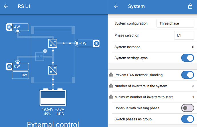

Hi, can you try setting "Number of inverters in the system to 1”, I think victron counts a three phase system (3 individual inverters) as a single inverter somehow.
I tried it and no change in behavior unfortunately. The manual tells that this setting is used to determine how to proceed when the CAN cable is broken and the CAN bus is splitted. After you have setted the 3 to 1 on inverters to start, did you do some restart?
Sorry, I have no idea, but if it thinks there should be more “systems/inverters” it might prevent it from starting.
I fumbled a lot before I got it working.

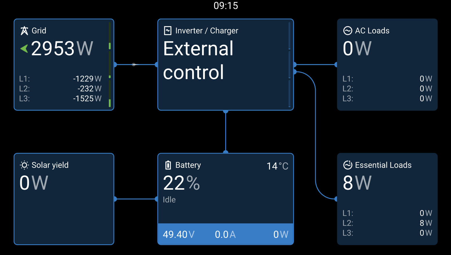

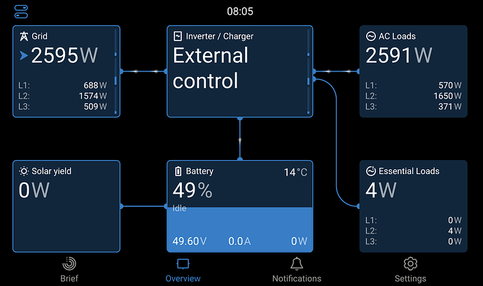

From where, in the world, it takes 3kW to feed into grid, with 0(zero)W from solar and 0(zero)W from battery?
You didn’t invented some SciFi power source and leaked by mistake the info here?..

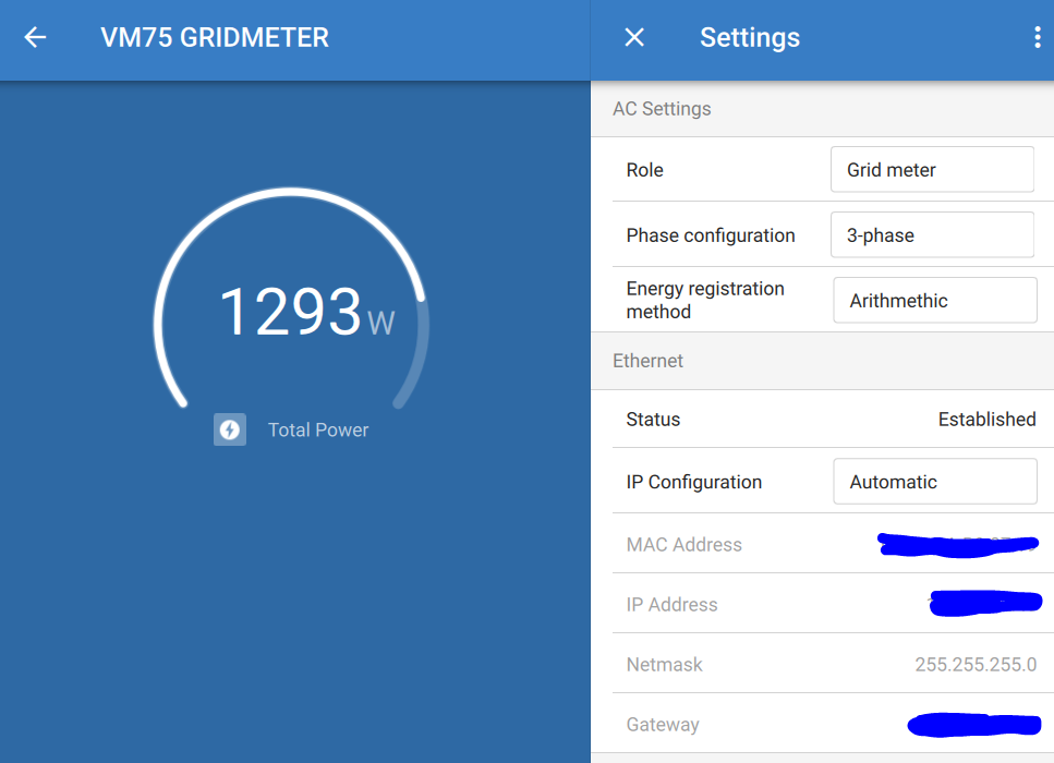

Isn’t VM3P75CT supposed to be connected over CAN?..
Or you are referring to the cable type?

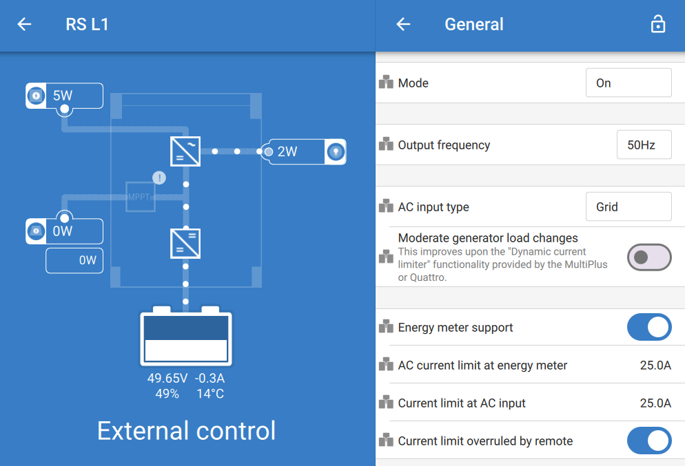

The Multi RS Solar is not connected to my mains, it is at my garage with only the load of the garage on it. The solar of my roof is also not measured here. So at this moment there is solar and no load seen by the multiplus, while it is not measured.
