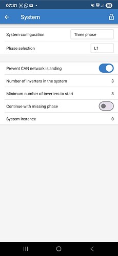

I configured it as a 3 phase system, L1, L2, L3.
i set the meter to 3 phase also, and set role to gridmeter.

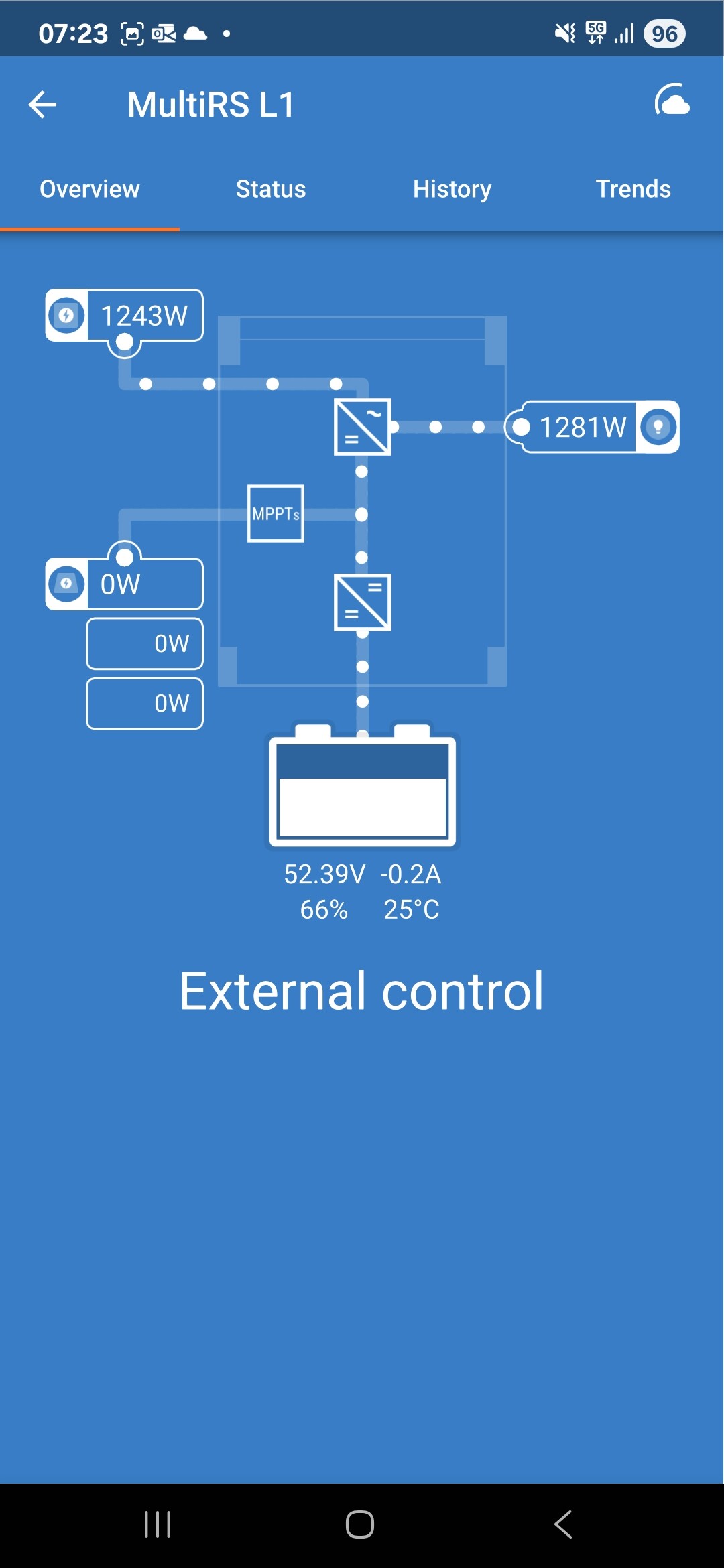

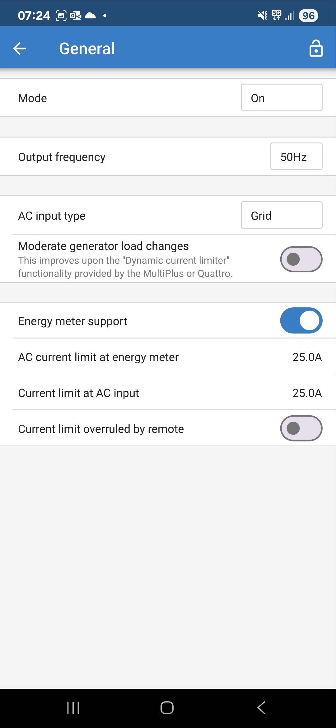

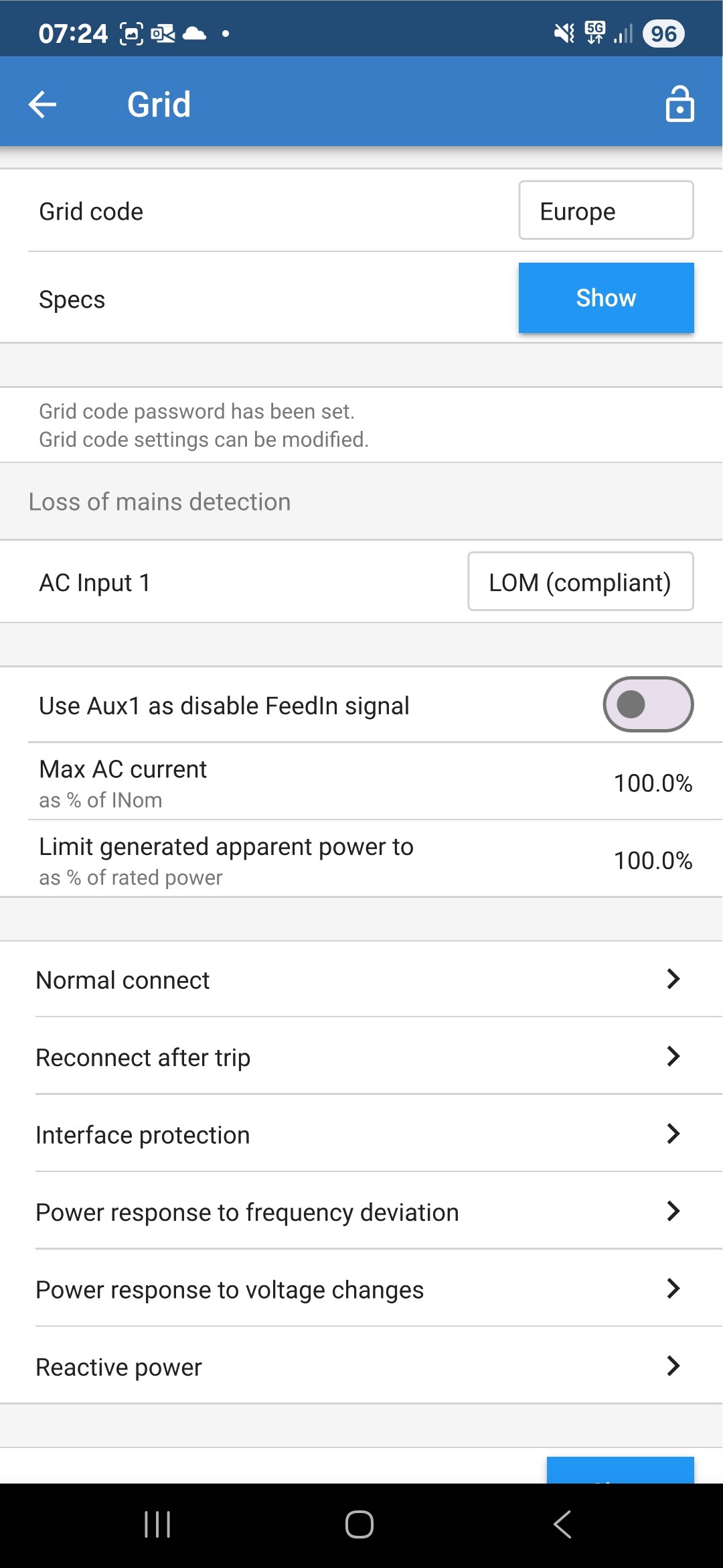

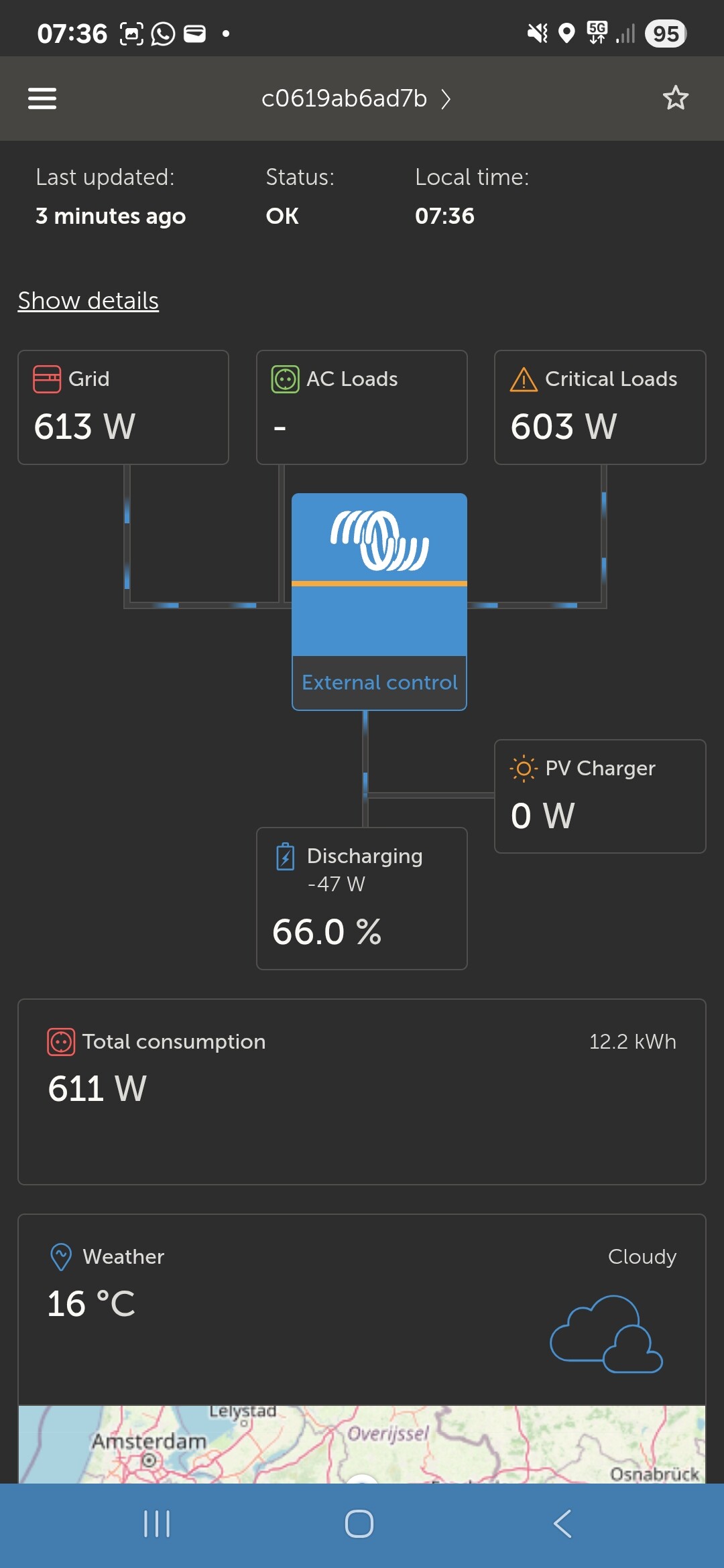

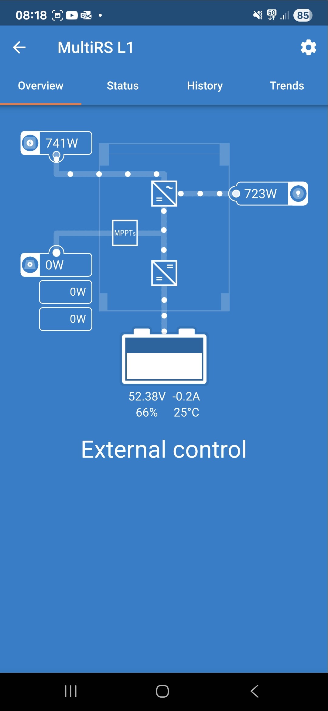

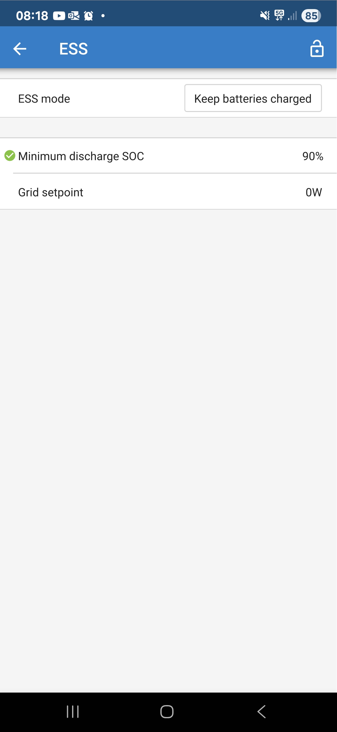

On the mobile app i was able to take some screenshots. I did this for the meter and L1.
I see the battery, it also has an expected charge and discharge current.
In the third screenshot ESS is set to keep batteries charged. This prevents discharging except on grid outage, see manual.
You can set the minimum SOC to 80% to test charging from the grid.
I already tried that, no change. I tried everything, grid setpoint does also not seem to apply. I think I have tried all modes, even pulling ac-in did not cause it to use the battery.
I just noticed this post
Setting it to 1… happy days…
Thanks for your help… after 4 days of pulling my hair out it seems to work. I will test some more
Glad its solved, bit of a unclear setting indeed
