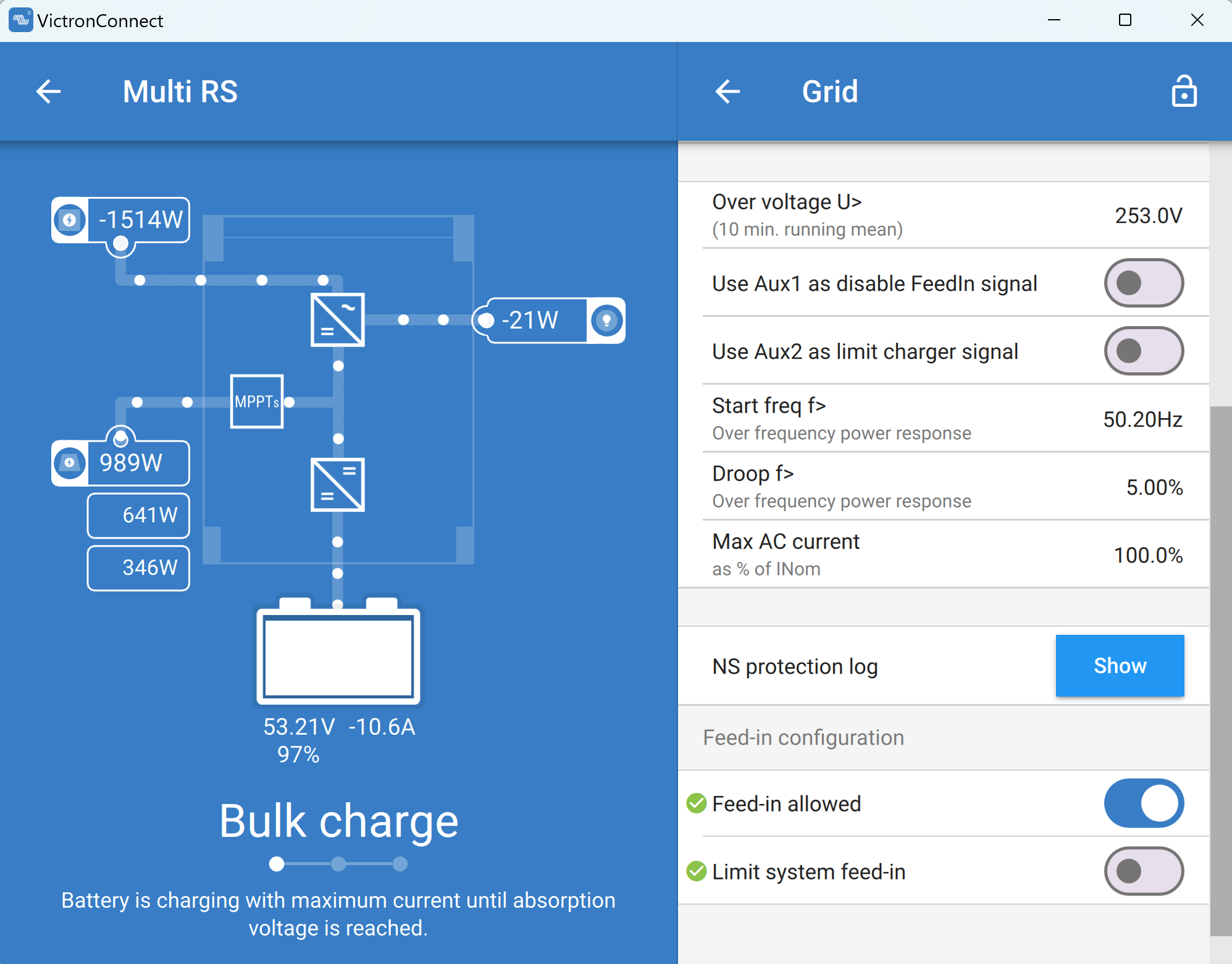

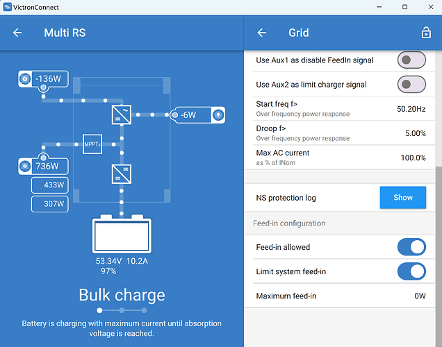

If I set the Maximum feed-in limit to 0W, it only applies to Phase 1:
It does not compensate for the consumptioin of L2 and L3.

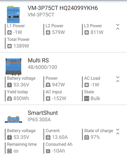

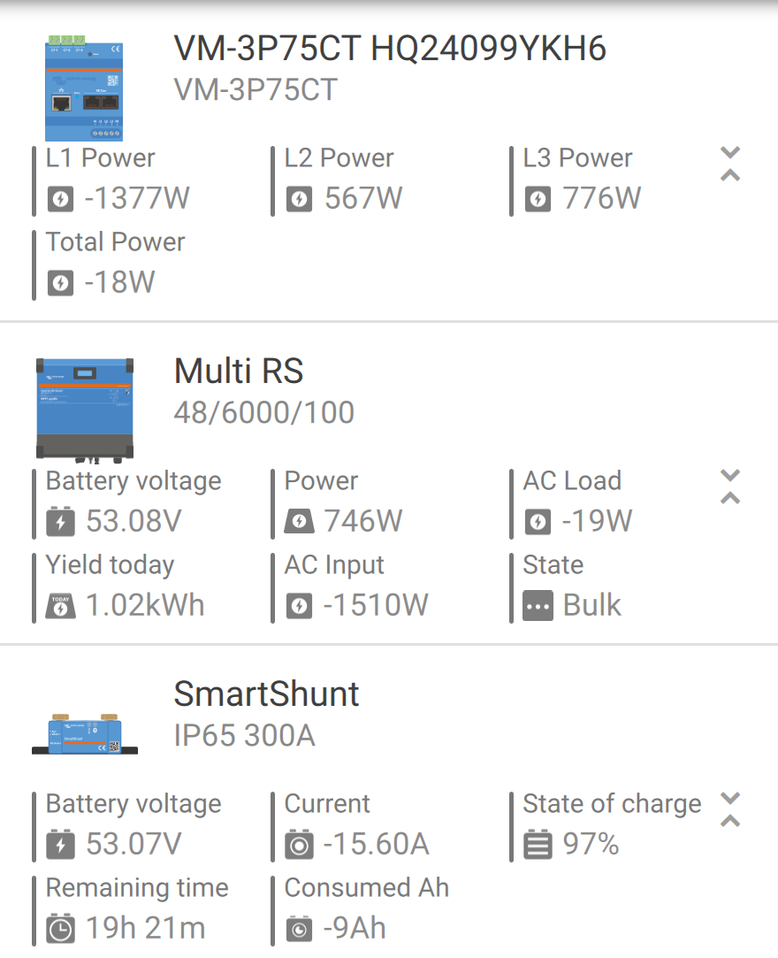

Multi-Phase regulation works just fine, without limiting the System feed-in:
But once the Battery is fully charged, excess solar is feed back to the grid.

You still have to allow Grid feedin in the Grid Settings of the Multi RS, if you want to compensate for the consumption of the other phases.
FW v1.31
If you use a MultiPlus-II instead of the Multi RS, it works.
The ESS settings are done in the GX-device in a MultiPlus-II system.
The ESS settings are done in the Multi RS in a Multi RS system.
