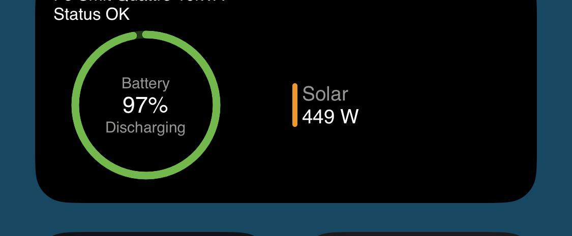

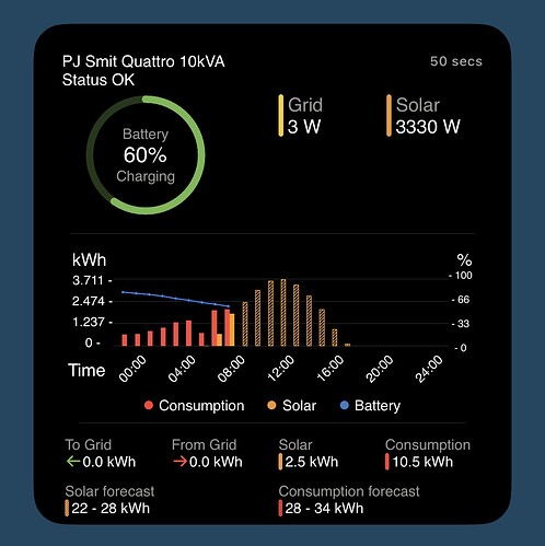

The Latest Widgets on iOS does not show the load. I have the latest iOS App available in the App Store and I have the latest firmware for all components in my system.

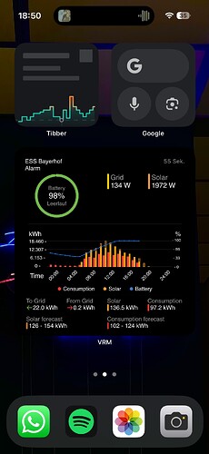

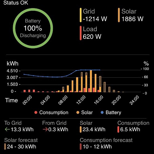

Yours looks different than mine?
There was a bug like this on an older version of the VRM app and related widgets but it was fixed some time ago.

I have re-installed the VRM APP and re-created the Widget. It is still not showing the load.
Some Solar and Consumption forecast data also seems to be missing after 17:00 hours.

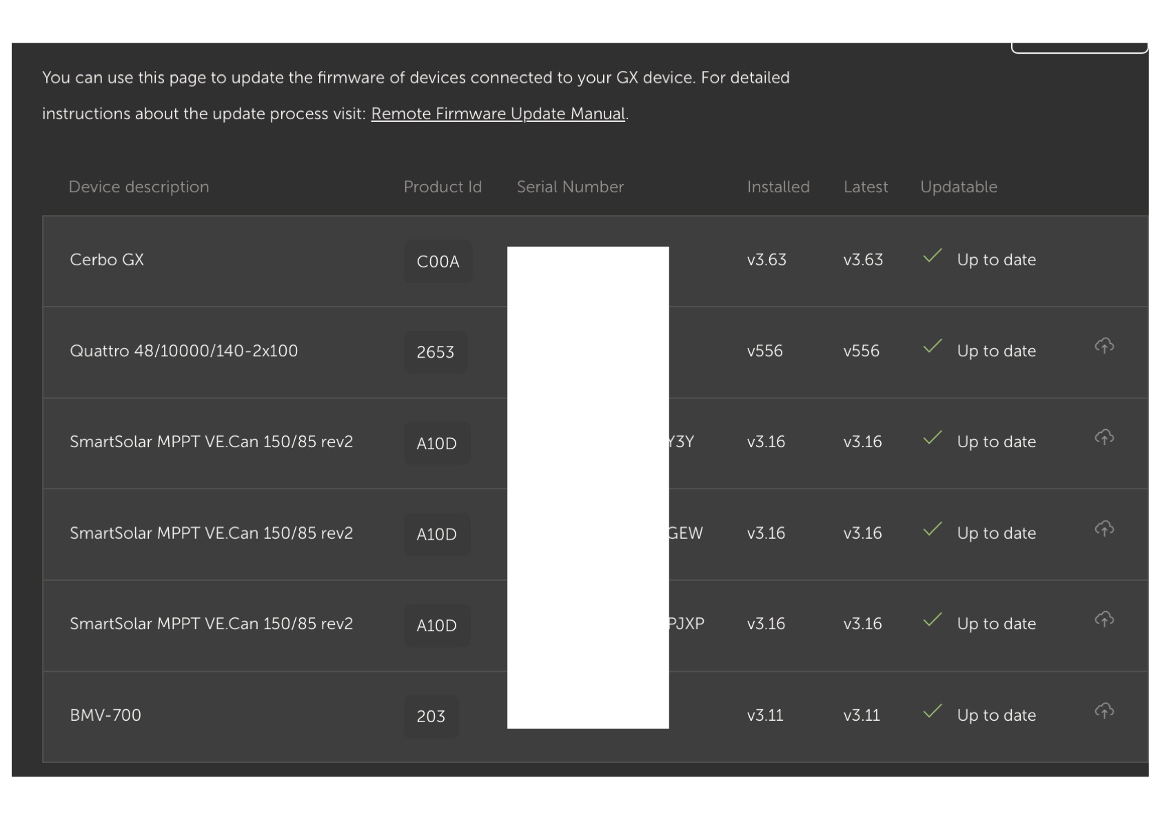

My setup consists of a Multi 5 kVA inverter, a 250/100 charge controller, a SmartShunt, and a Cerbo GX. After the inverter’s most recent firmware update (to version v556), the load indicator disappeared from the widget on my smartphone.
When I repeated the update procedure, I found that the inverter wasn’t being assigned its serial number like the other devices. I’ve attached a screenshot.

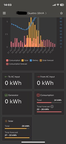

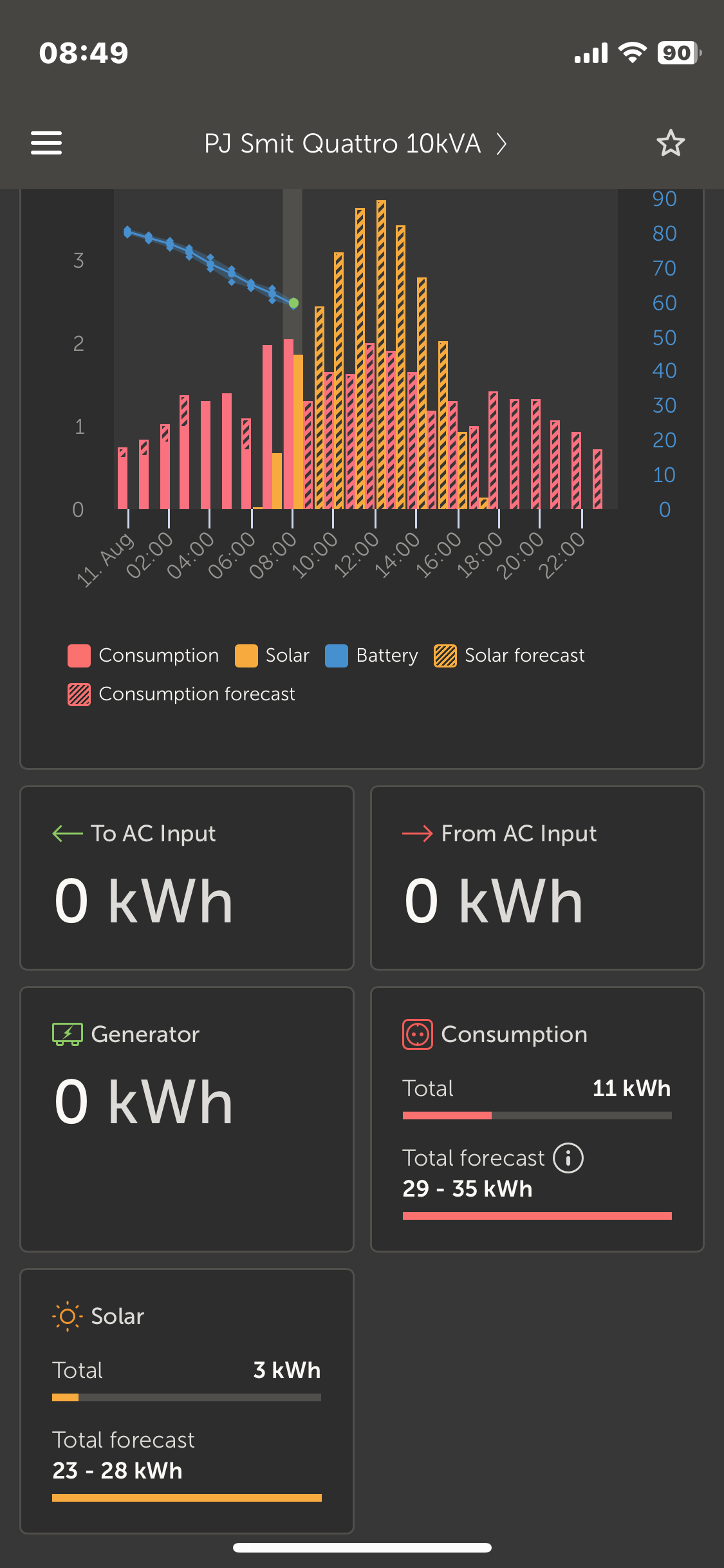

My VRM App shows everything as expected, but the Widget on iOS still does not show the load. It shows the Solar forecast, but NO load forecast.
It does not seem as if the load display will be coming back on the widget. Does anyone have a suggestion on how to view the load on a widget, or should I just abandon all widgets and open the VRM App everytime?
