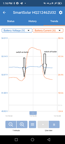

see pictures, numbers might not be the same, but the problem is not giving full available power to charge the batteries. This was not the case from the beginning, this change in behavior is recent. Probably a change that came with a firmware update, I suspect the CerboGX not handling the BMS values from the batteries correctly?

No problem, I can understand that change in lower voltage, but clearly the MPPT can deliver 2500w easy, however only 1500 is send to the batteries. Makes no sense at all. The diagram with the voltage and current is from the MPPT and shows when I switch on the water heater and back off again. Showing that there is way more power available, but again it is not used to charge. There is some kind reason in the algorithm that limits it. I want to know what that is, because as it sits now, my system is pretty useless, because no matter how many solar panels I install the charge is always limited and I cannot get these batteries ever again at 100% which is needed to balance them correctly.
As soon as the DVCC target of 52.4V is reached, the MPPT starts to throttle.
According with your first screenshot, the voltage at the MPPT output is 52.4V, so…
