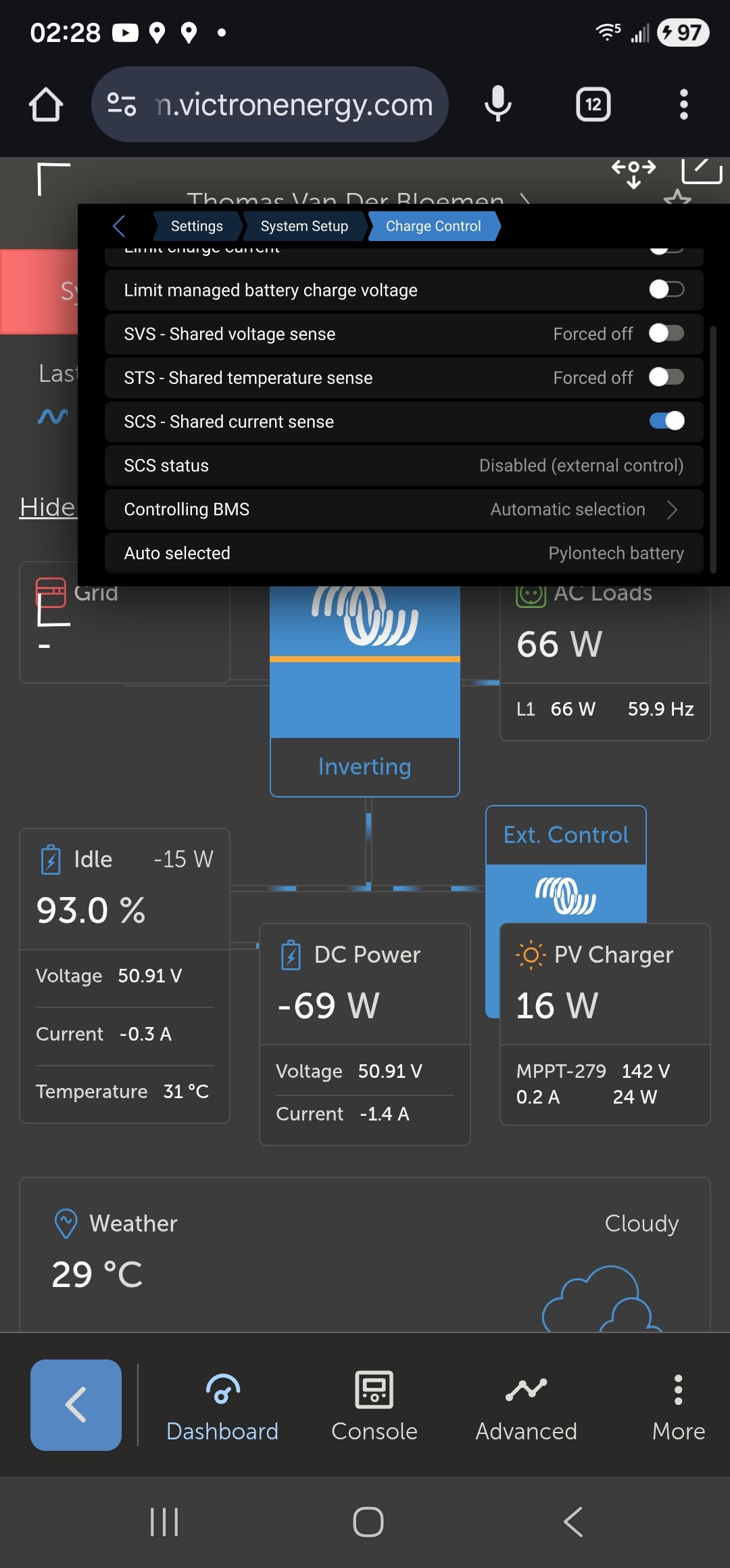

Thank you sir. I checked the consol settings. It is set for auto but shows the Pylontech as selected.
Your multiplus is indeed measuring 52.5V, while the battery reports 50.5.
2V off is massive, but in this case it means that what the multiplus consideres as a 52.5V Chargevoltage is just equal to the voltage your pylontech has at 93%.
So, you should more likely check the connections of the Multiplus. (With DVCC enabled, the Solar-Charger won’t use it’s internal measurement, but the Multiplus’ value.)
Also check if the fuse / breaker you have used may eventually cause a 2V Voltage Drop, so the difference is not a measurement error “but real”.
(A Fuse that was once close to melt could have a significant higher resistance than it should)
