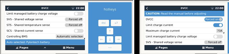

how can I limit the charging current of Pylontech 4x US3000C (14kWh) in Victron system (currently 6kWp, I want to expand panels to 16kWp to cover autumn and winter)?
I have 2x MPPT250V/60A Victron (would be expaded to 6x MPPT250V/60A), Cerbo, 3x MPII 3000VA .
Setting in DVCC is not working - I set it to 70A, but the current often exceeds 100A.
Apparently, this is because the current limitation in DVCC does not work for some reason if I have overflows (export to grid) enabled - stupid limitation.

limitation in DVCC in GX does not work (in case of export to grid). I did set it manually to 70A. But I can see 130A on sunny day going into the battery.
