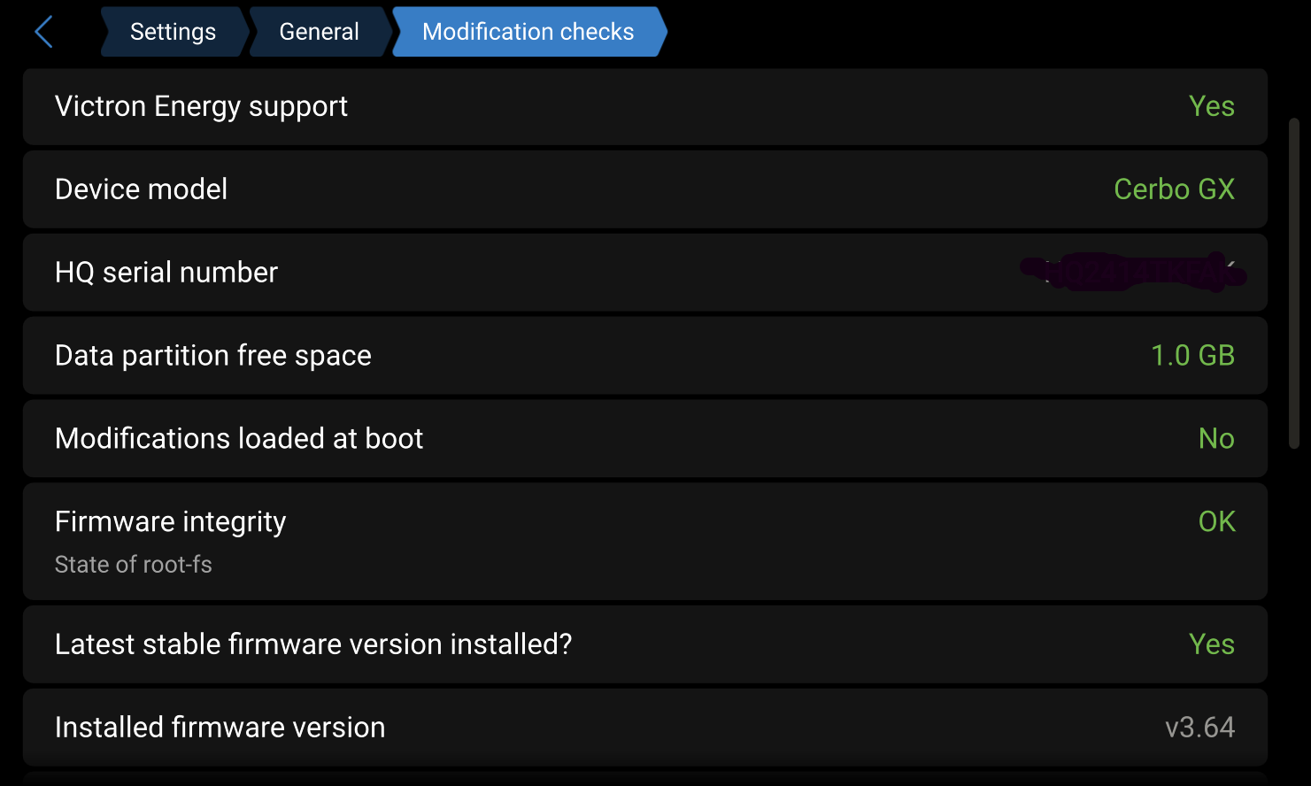

Do you have any mods running on the Cerbo?
Maybe a mod causes a full data partition which could cause issues?

No mods on the Cerbo.
I am using the “Large” image. I had intended to check out Node-Red, but I didn’t get around to it yet. Or rather: I didn’t need to, because Home Assistant does everything I need via MQTT. Mostly: adjusting the DVCC current to slow down charging when the battery gets close to full, and increasing it again when SOC drops.
Can you confirm the /data partition (or any partitions for that matter) aren’t full.
On the current version you can check via the UI in settings → general → support.
It isn’t clear from your reply. thanks.

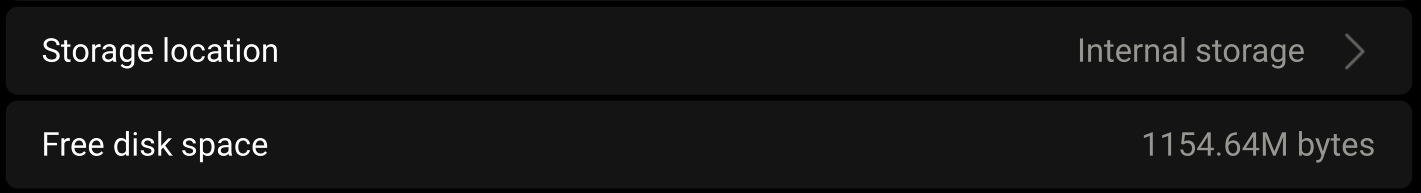

In Settings → General I don’t find “Support”.
Perhaps this info found under Settings →VRM refers to the same partition?
Interesting info about certificate expiries. Ok, I’ll write a script to regularly update the certificate downloaded to my MQTT broker. That will cover both this current issue and the future reduction in certificate lifetimes.
What version are you on? It might be called modifications in an earlier version but this pretty much since 3.63 iirc. VRM often refers to the logging SD card assuming you have one.

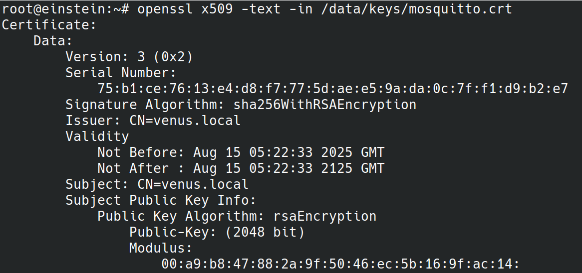

Are you able to ssh into the cerbo and give me the output of openssl x509 -text -in /data/keys/mosquitto.crt.
About the certificate lifetime BTW: that’s irrelevant. The MQTT certificate is a long-lived self-signed certificate to be used by non-browsers, meaning the two parties who enforce that lifetime rule (certificate authorities and browser makers) don’t come into play.
Thanks for persisting. I found it. :slight_smile:
Called “Modification Checks” for me. Still plenty of storage, 1GB available.

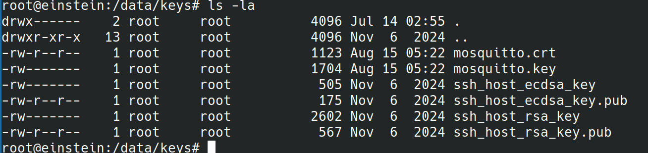

I did a bit more digging. This is the directory they keys are stored. Only the mosquitto key was renewed, the host key was not changed since it was first created back in November.
I also checked /var/log/mosquitto/current. It only shows ‘Generating a RSA private key’ one single time, and I believe that log file dates back to when I first started the Cerbo and enabled MQTT. The number of times it shows ‘*** CCGX booted (0) ***’ right at the end is consistent with what I’d expect since back then.
I am at a loss why the key was changed. I even did a reboot again (not power off), this time the key remained unchanged.

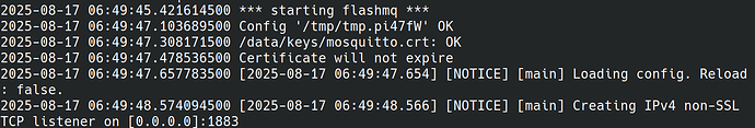

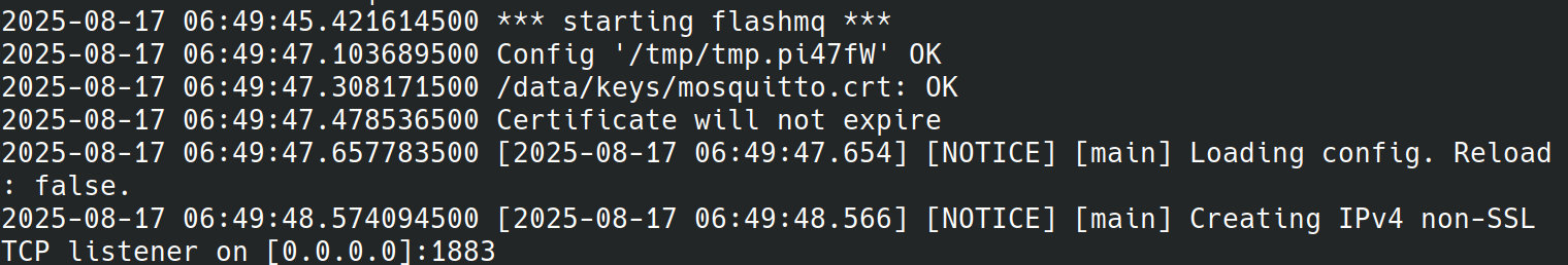

The correct logs would actually be in /var/log/flashmq. Can you look there as well, including the rotated files (so not just current)? Use ta64nlocal to see the actual times.
For example:
grep -A 5 -i -F '*** starting flashmq' /var/log/flashmq/*
Unfortunately there are only 4 files in /var/log/flashmq, all last modified today. The only thing grep finds is from today’s reboot:
Is there a way to increase the number of rotated files that are kept in future?
tai64nlocal has been a great tip though. It helped confirm 2 things: the only time mosquitto generated a key was the day I got the Cerbo:

But: the modification time of the key file is exactly the time of Friday’s reboot:
2025-08-15 05:22:05.124365500 *** CCGX booted (0) ***
2025-08-17 06:49:25.102505500 *** CCGX booted (0) ***
root@einstein:/var/log/mosquitto# ls -la /data/keys/
drwx------ 2 root root 4096 Jul 14 02:55 .
drwxr-xr-x 13 root root 4096 Nov 6 2024 ..
-rw-r--r-- 1 root root 1123 Aug 15 05:22 mosquitto.crt
-rw------- 1 root root 1704 Aug 15 05:22 mosquitto.key
I guess for now, with the old flashmq logs gone, we have reached the limits of the investigation? At least if it happens again, I can go and check that log straight away.
Ok, after a couple more reboots, the issue did happen again. Here’s the relevant part of the output:
/var/log/flashmq/current:@4000000068a1b92a0daf807c *** starting flashmq ***
/var/log/flashmq/current-@4000000068a1b92b058f550c /usr/sbin/start-flashmq:
line 28: 1487 Hangup /usr/bin/flashmq --test-config --co
nfig-file "$tempconf"
/var/log/flashmq/current-@4000000068a1b92b134382cc .+......+.......+..+.+..
No idea what 1487 Hangup might mean, and Google was of no help unfortunately. But the testing the test configuration file fails, and as a result new key is generated again.
Venus platform sends a HUP signal to reload FlashMQ settings. It does this with ‘killall -HUP flashmq’. But, apparently it does this even before FlashMQ is started, and targets the temporary flashmq used for testing the cert. Because in that mode it doesn’t have a signal handler, it aborts.
It’s an unexpected and very coincidental race condition.
