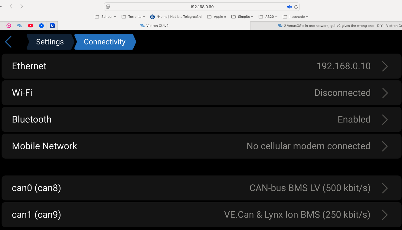

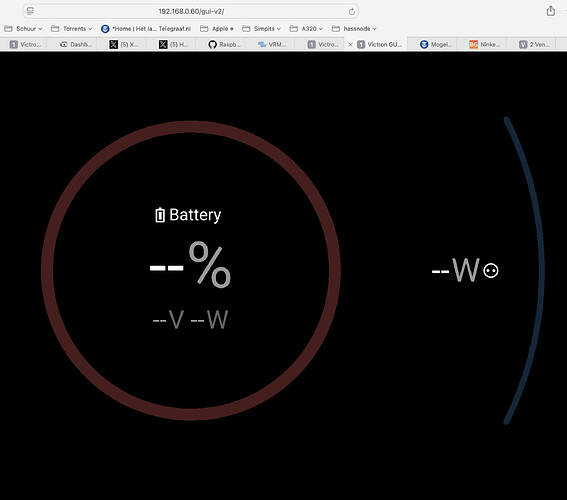

Thanks for checking, In this pict you can see the gui–v2 interface shows the data from the rasp on 192.168.0.10 when my browser goes to the cerbo on 192.168.0.60

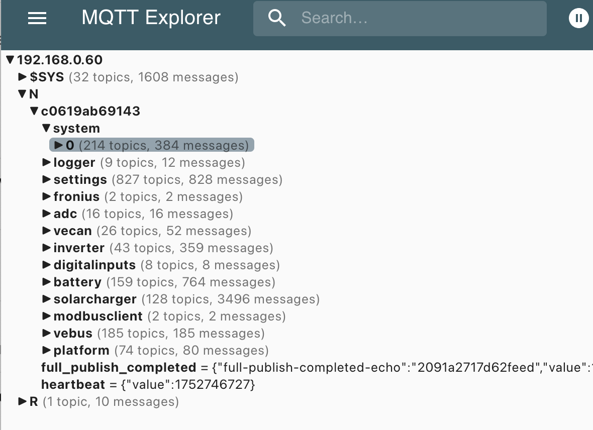

in mqtt explorer I see on the cerbo (192.168.0.60) that both the cerbo and the rasp (192.168.0.10) are published, is that normal behaviour ?
Which broker is MQTT explorer connected to?

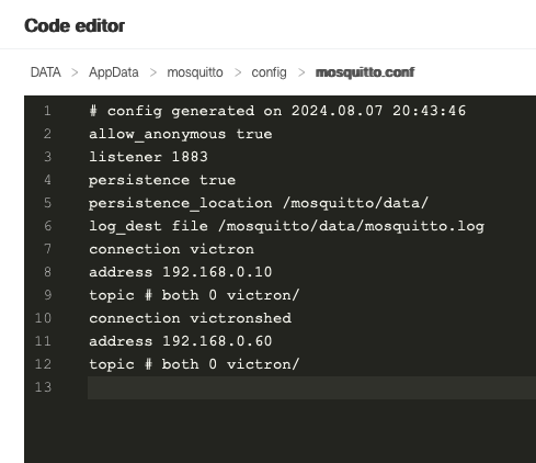

Have mosquito running with this config file
Turning mosquito off gives this in mqtt explorer

I now understand that Mosquito was adding topics to the Cebro broker that
prevented me to connect with gui-v2, my bad, thanks for the help.

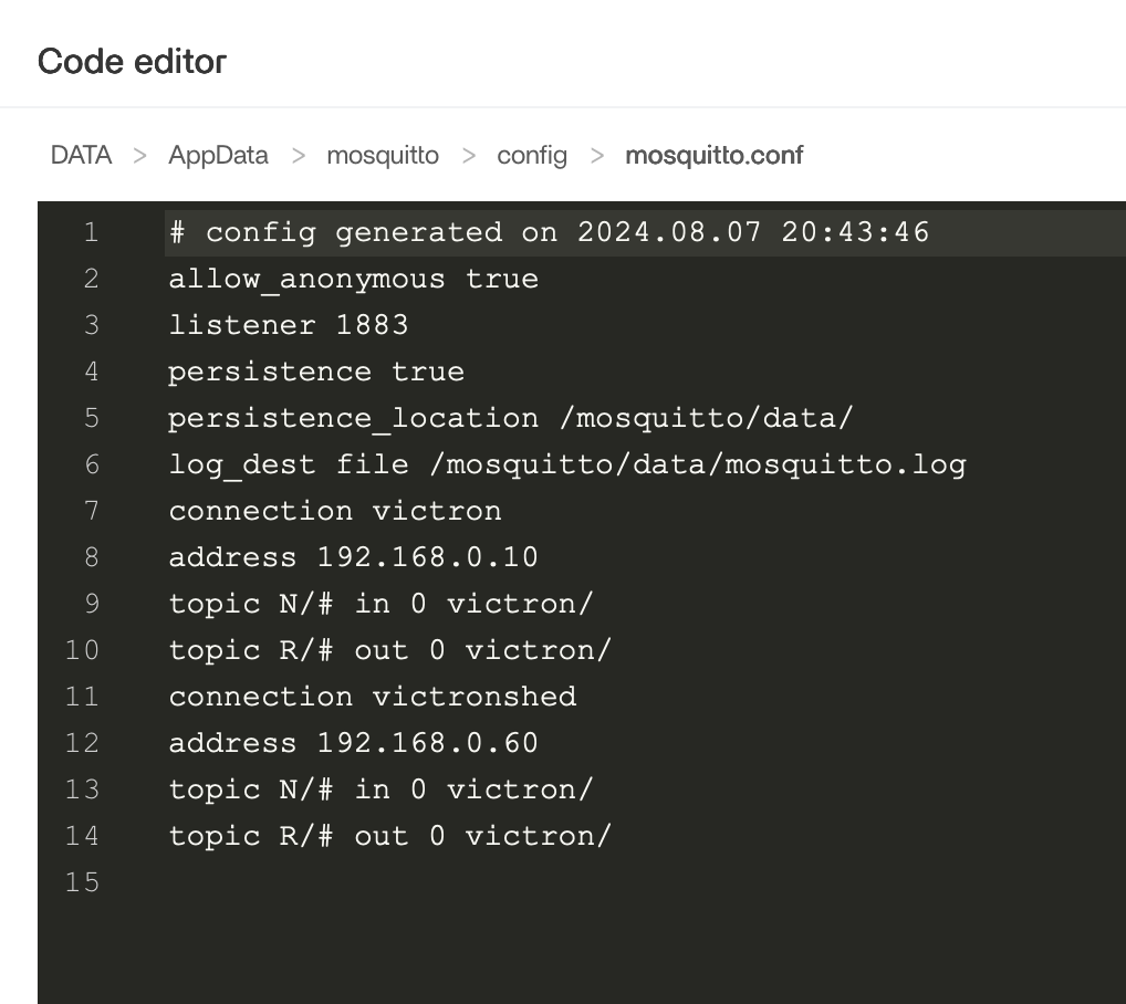

this Mosquitto config file works for me (with rasp and cerbo in the same network)
using Mosquitto to get the Victron data of both installations into Homeassistant
