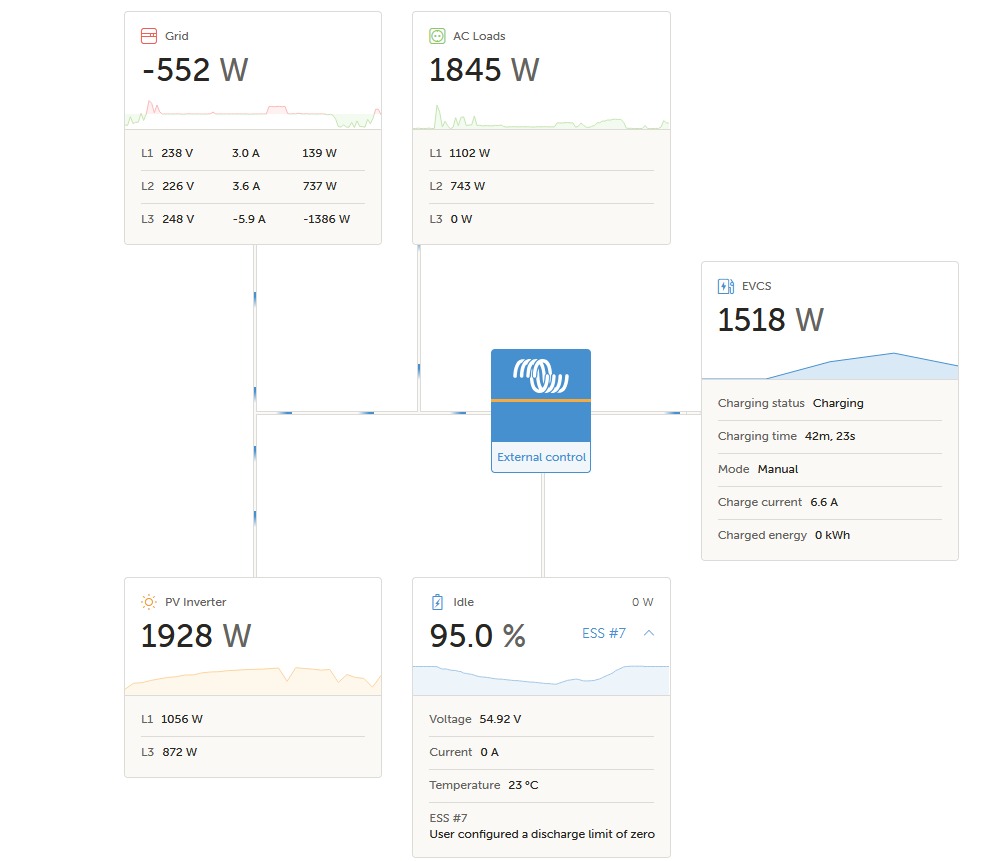

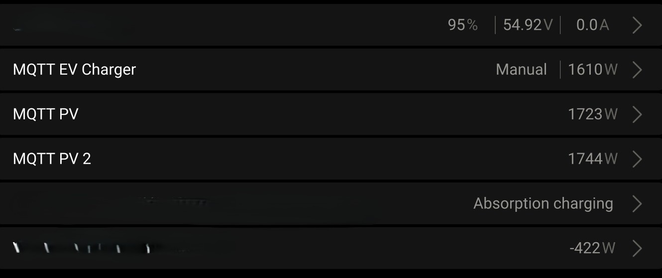

Ive implemented the data from my pv installatioin wich reads well on the bus:
but data (sum) is not calculated as it should. Don’t know why… power for pv is on L1 power for pv2 is on L3
found the problem, looks like VRM does not use sum of total power from the inverters, instead it uses L1, L2,L3 power in my case it was appointed to the wrong values…
