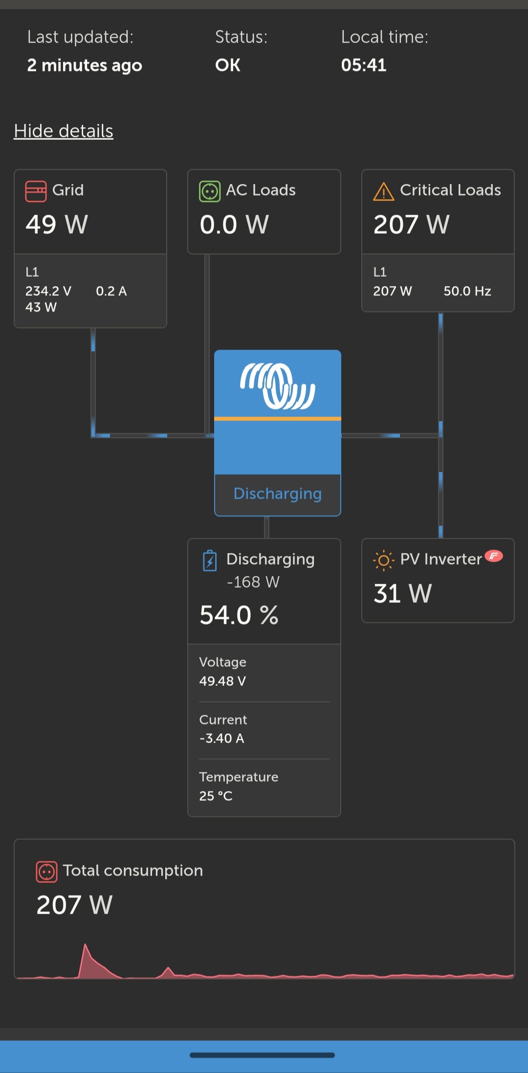

In my VRM account I have 2 almost identical systems but for one of them the available options look different or are missing. For example, the option of “Firmware Update” and “Remote VE Configure” or the “Controls” button on the “Dashboard” page are missing. Does anyone know why or what needs to be changed?

I activated Two-way-communication and now it works. Thank you!
