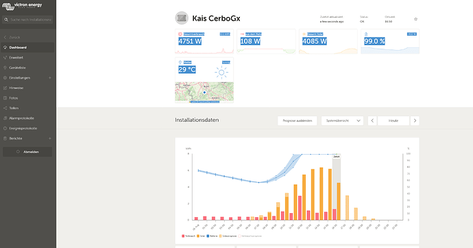

did something change recently? My Dashboard looks like this suddenly and i can’t change any setting or see live data. Also no remote control.
Any idea?

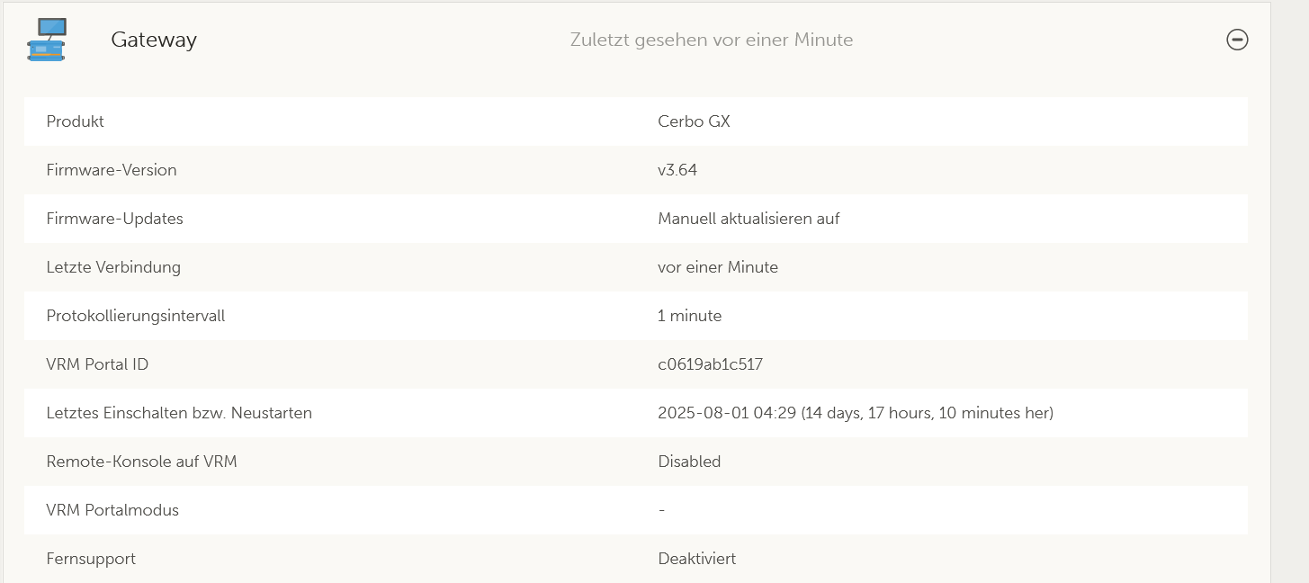

This is all i can see :slight_smile:
You are already on the last recommended stable firmware.
To install a beta you need to change the settings in the GX device.
So you are saying that this weird Dashboard/VRM cant be fixed without the beta FW? How do I access the DX device (Wi-Fi Hotspot or Bluetooth via VictronConnect?)
No, it shouldn’t look like that with the normal FW.
I would try to reboot the GX device.
On your Screenshot it says “Remote Console disabled”.
You need to connect locally with the IP or venus.local and than check the settings.
