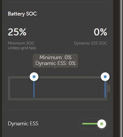

Hi team - in browsing the VRM API docs I noticed a setting called “isDessSocDifferent”. Does this actually work? I would like to add a 5% buffer between the ESS min SOC and DESS min SOC. Our system is quite large (4x 10k Quattros) so the scheduler often underestimates consumption given it ignores the 400-500W draw of the Quattros themselves (causing unintended consumption from grid during peak hours, when the battery is near min SOC)

For fun, I just enabled it…VRM does show a new UI element but I can’t seem to adjust it.
