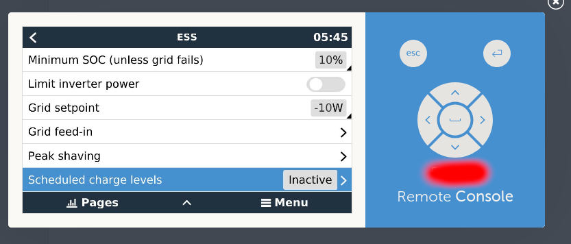

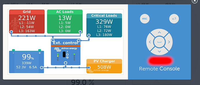

There is now a constant energy draw of around 200 watts from the grid into the house, even when there is sufficient PV generation and/or battery state of charge available. It appears that the system is no longer regulating grid import to maintain the setpoint at 0 W, as it should.
I’ve tried various troubleshooting steps—adjusting the grid setpoint, changing the ESS mode, etc.—but I’m now at a loss as to what the system is actually doing. It shows as being under “external control” (which is expected), but it continuously keeps the battery at 100% charge and remains in “bulk” charging mode. I suspect there may be an issue with the voltage settings—this is a 14x Pylontech US3000C configuration, and I’ve followed the voltage and configuration guidelines from the Victron Wiki—but I’ve double-checked everything multiple times.
As far as I can tell, the battery is no longer being discharged at all; it is simply held at full charge.
