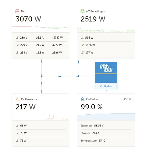

I’m having trouble with a Victron ESS system that used to operate correctly in trade mode, but recently it stopped behaving as expected. Instead of following the charging and discharging setpoints, the system remains in inverting mode or charging mode for days or even weeks at a time, without reacting to grid conditions or scheduled behavior.

In VRM, I can see the correct charge and discharge setpoints being generated at the right times, but the MultiPlus units simply do not react. The EM24 grid values are visible in VRM and on the Cerbo console, so basic communication seems to be working.

When ESS starts discharging, the output ramps up to around 5 kW. Shortly after, the battery current begins to drop, and I notice an unusual reading on the grid: it looks like power is being drawn from L2 and L3 and injected back into L1. :roll_eyes:
