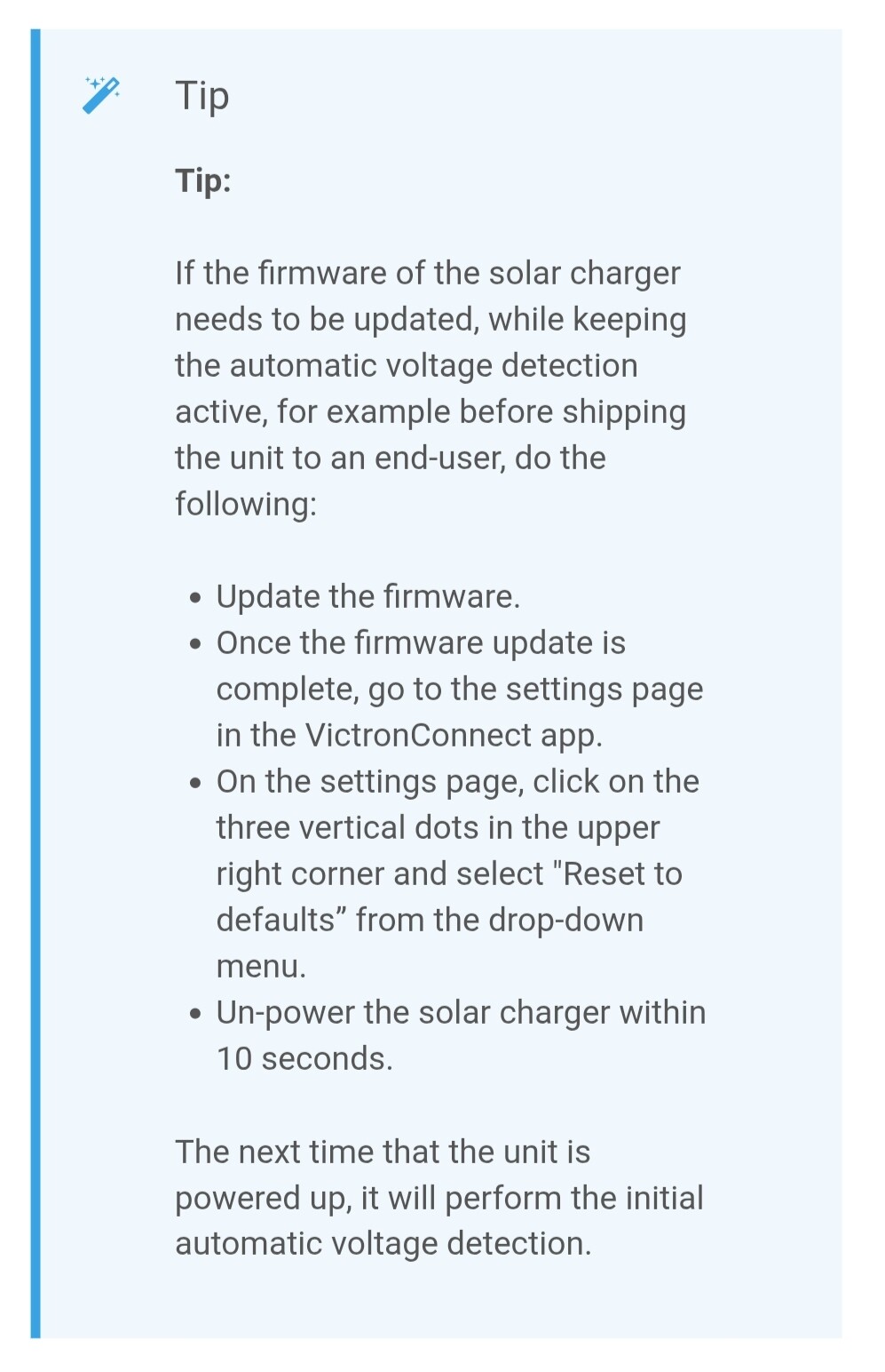

Hi, bought a used one from ebay and its been charging my agm batteries (parallel, both reading equal voltages) at 16v, only bulk. Ive read the manual and it says it locks into the first battery voltage after reset, they used a12v 7ah lithium. Im to understand that it doesn’t lock in battery type, only voltage and the seller’s husband is a victron technician and she said he reset it correctly including turning off within 10 seconds.
So whats the issue? Well, the problem and solution without doubling the cost with a ve.direct to usb cable

Never heard of this 10 sec turn off requirement., possible remainder of comment is bs also.

If you do a factory reset you also reset the automatic voltage selection, so you need to turn the device off before it does the automatic voltage selection.
That way the device will detect the correct voltage the next time it gets connected.
