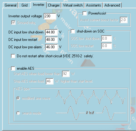

Here are the settings in VE Configure:

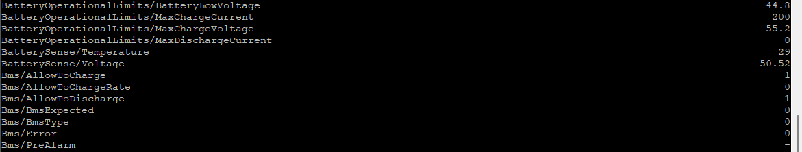

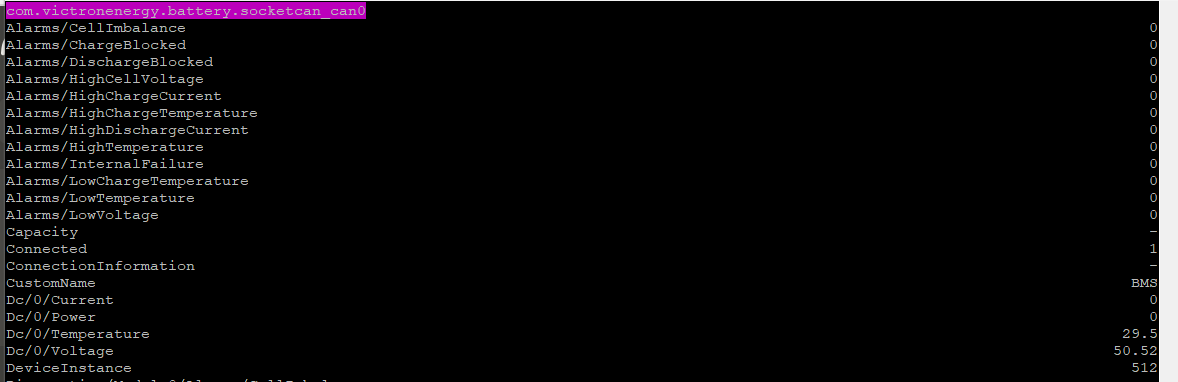

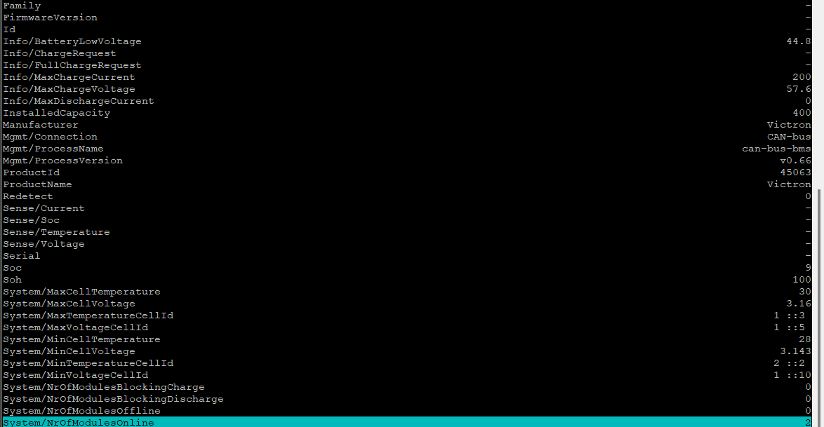

I also don’t see any alarms coming from the BMS (via dbus-spy), but I do see the ‘Info/MaxDischargeCurrent’ set to 0:

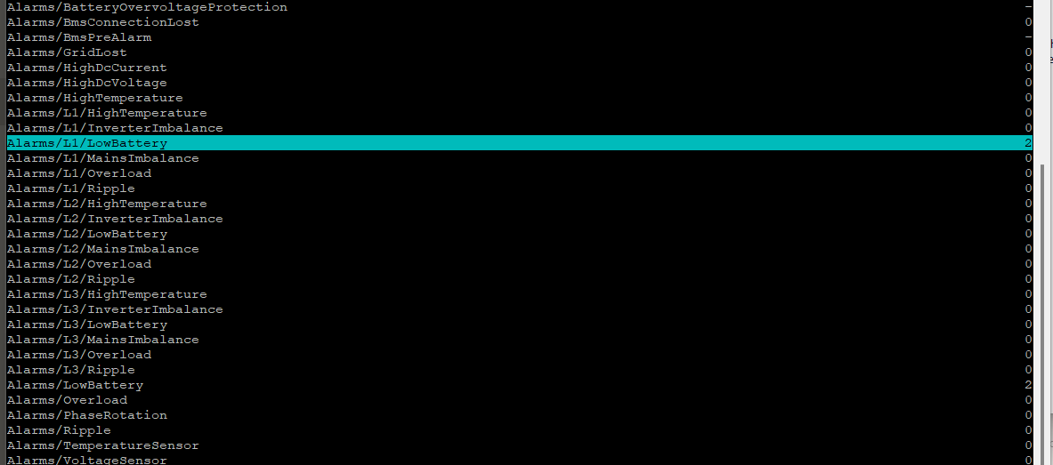

When I look at the MultiPlus dbus data, I see that ‘Alarms/L1/LowBattery’ is set to 2, which I suspect is blocking discharge:

Now for the question: Is the MaxDischargeCurrent value of 0 the cause or the consequence of the MultiPlus alarm? Do you see any other peculiarities?
