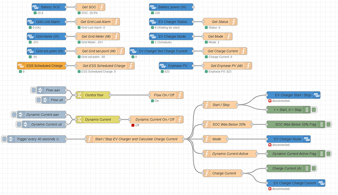

with the latest beta the problem with the EVCS (NS) still exists.
–> The device is no longer available via the stored service path. Please (re)select the device from the dropdown and deploy again.
Measurement is gone and also not selectable.
Have you tried deleting the EVCS node from the flow and dragging a new copy in ?
This refreshes some cached information and maybe a changed instance ID.
Needless to say the EVCS should be connected to the network and recognized by the GX before it can be used in Node Red.

I do see that it isn’t working correctly on your system. Not sure (yet) on the cause. I was suspecting the #-sign in the custom name of your EV charger, but tested that on another system and that doesn’t seem to be causing problems.
