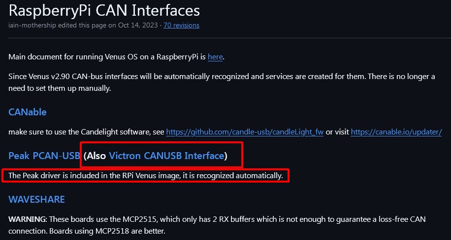

Sorry, but in the light of the above said, what about these?
Are they not officially supported?
In the end, it’s your advertised product…
We don’t provide official support for the raspberrypi.
And exactly the issue that is going on here has been mentioned on that page you linked to. By the looks of it for years already.
I don’t understand why we need to discuss this. Surely you can’t expect us to dive onto each and every corner case, especially with a raspberrypi
And the product used here isn’t even the victron usb can dongle.
Its some other device, apparently broken, or not, in a recent kernel.
And the people responsible for the product are not even responding to that issue.
For the raspberrypi we need more doing and less discussing (!).
