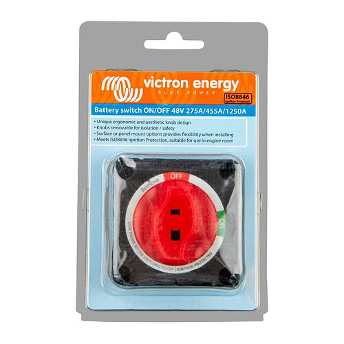

When I bought the switch back then, there was also repeated talk of “cheap” copies. They look identical and are sometimes even sold as Victron products, but apparently the quality isn’t as good. Someone on this forum even did a comparison once and found some significant differences (if I find the post, I’ll link to it here).
Anyway, that’s why I wanted to ask: is it an original Victron product? Did it arrive in sealed blister packaging with the Victron logo?
