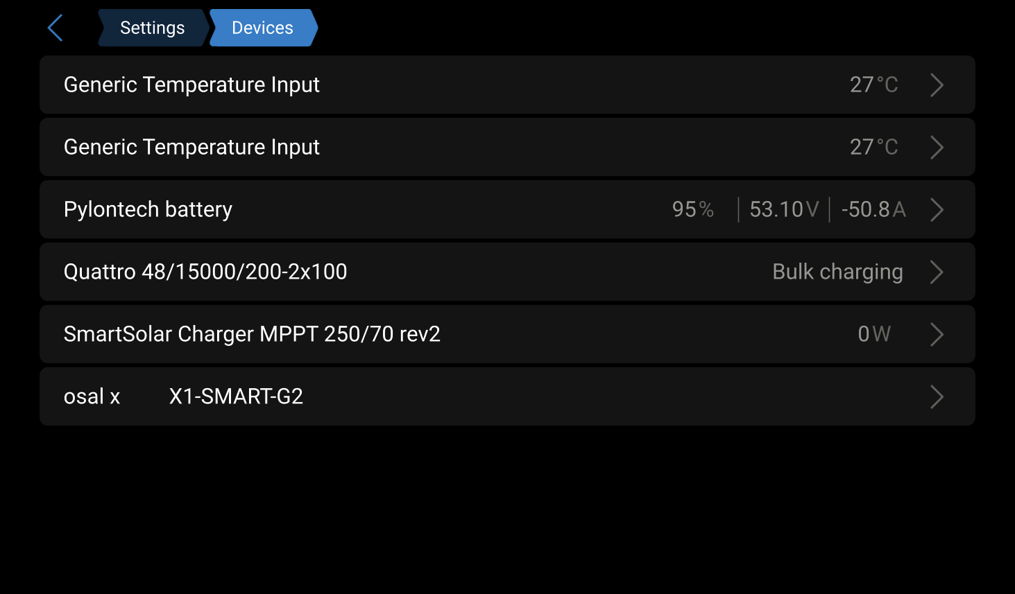

I have been using Solax inverters with Victron for several years now. They are cheap, reliable so far, support zero feed-in, and are available in my area. I have already installed two systems using them on the AC-Out of Quattros in three phase. All of this works fine, except the only way to see the power produced in VRM is with a grid meter.

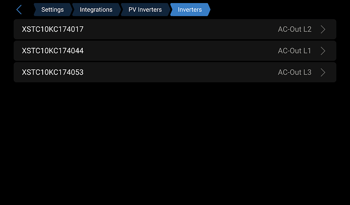

However, these inverters support Modbus TCP, and they even show up in the device list via the sunspec PV inverter scanning capabilities of the Cerbo GX.
The only problem is that the data is not populating, probably because the device is not compliant with the sunspec protocol. And because the Cerbo GX is connecting immediately via the PV inverter function, I’m not able to connect with other tools as the inverter only connects with one controller at a time.
