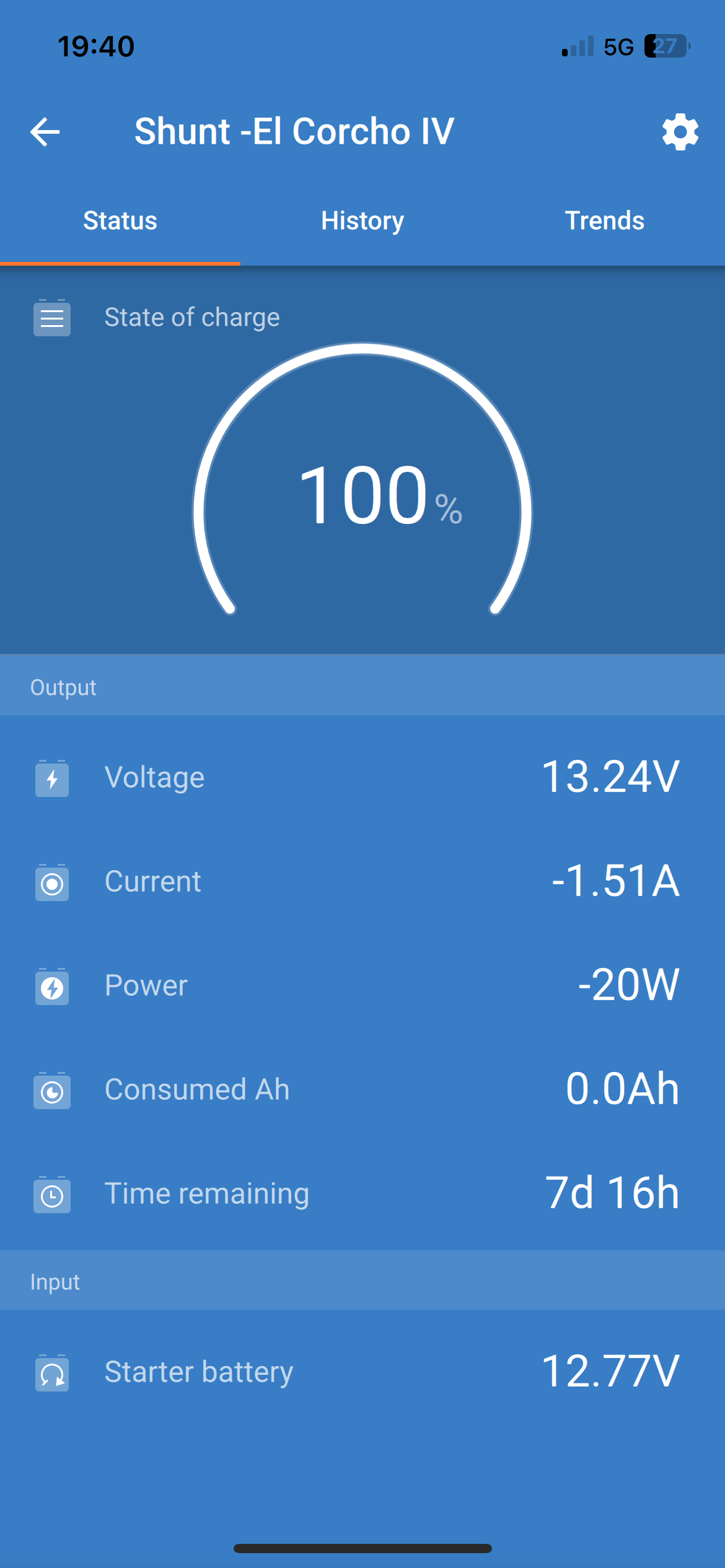

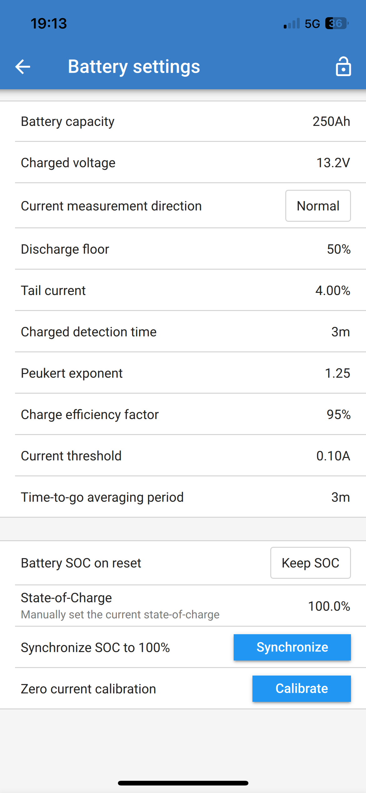

At first it seemed as if all worked well, the app showing realistic values for the shunt and other components. I charged to full, synchronized and still seemed ok.
Then after a while I notice that consumed Ah where higher than my SOC-%, not a big difference but a few %-p off.
Then I left my boat at 87% SOC, with fridge running for 24 hours, expected to come back to maybe 80% SOC, but when I got back the app showed 100% SOC! no charger connected (no solar panel, nothing), and also the history on the app didn’t show any consumed Ah.
Do you have any idea why this may be? (I of course believe everything is correctly installed, including sensor cables to the both the starter battery and the consumption batteries, but…?
