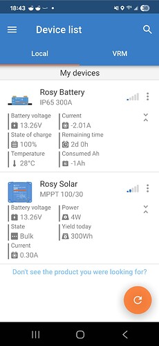

The issue I am running into is that the SmartShunt sets the batteries at 100% SOC when the voltage gets high enough, even though there’s no way the solar system put out that much power.

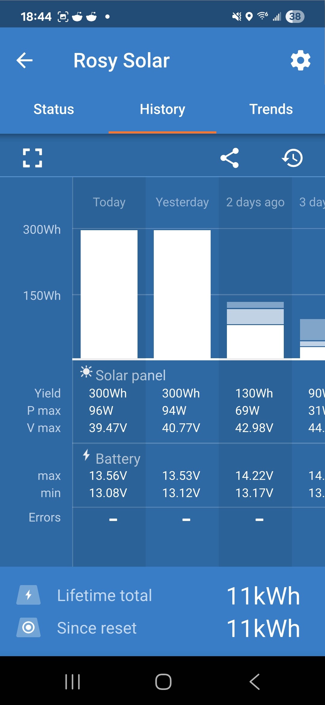

I have 160W of solar, and yesterday the batteries were at 50% SOC, the solar panels generated about 300W total for the day, there’s a constant drain of about 2A on the system, and the Smart Shunt decided that after maybe an hour of charging (perhaps 50-80 watts) the battery SOC was at 100%.
