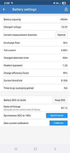

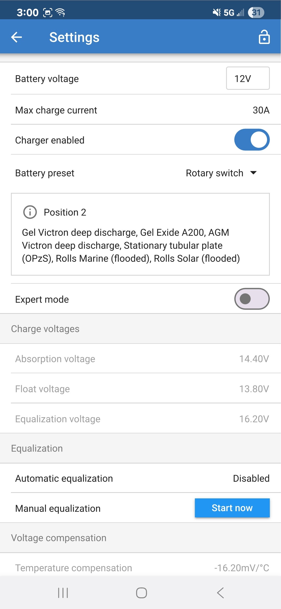

The 1st one is from the smartr shunt. And the 2nd is from trhe controller

I can not see anything wrong with your mppt settings to explain why it is not charging. The usual reason for it to go into float is a poor connection, blown fuse or cheap breaker like the ones shown below between the mppt and the battery. This would be easier to diagnose with a status screenshot. Is the battery voltage listed as 13.80V. Check all your wiring. Use a multimeter to check mppt terminal voltage and battery voltage.
Your smartshunt settings need some changes.
Battery capacity 245Ah (do not add together when connected in series)
Charged voltage 14.2V
Tail current 2%
Charged detection time 3 min
Peukert 1.15
Charged efficiency 98%
See Shunt settings explained
