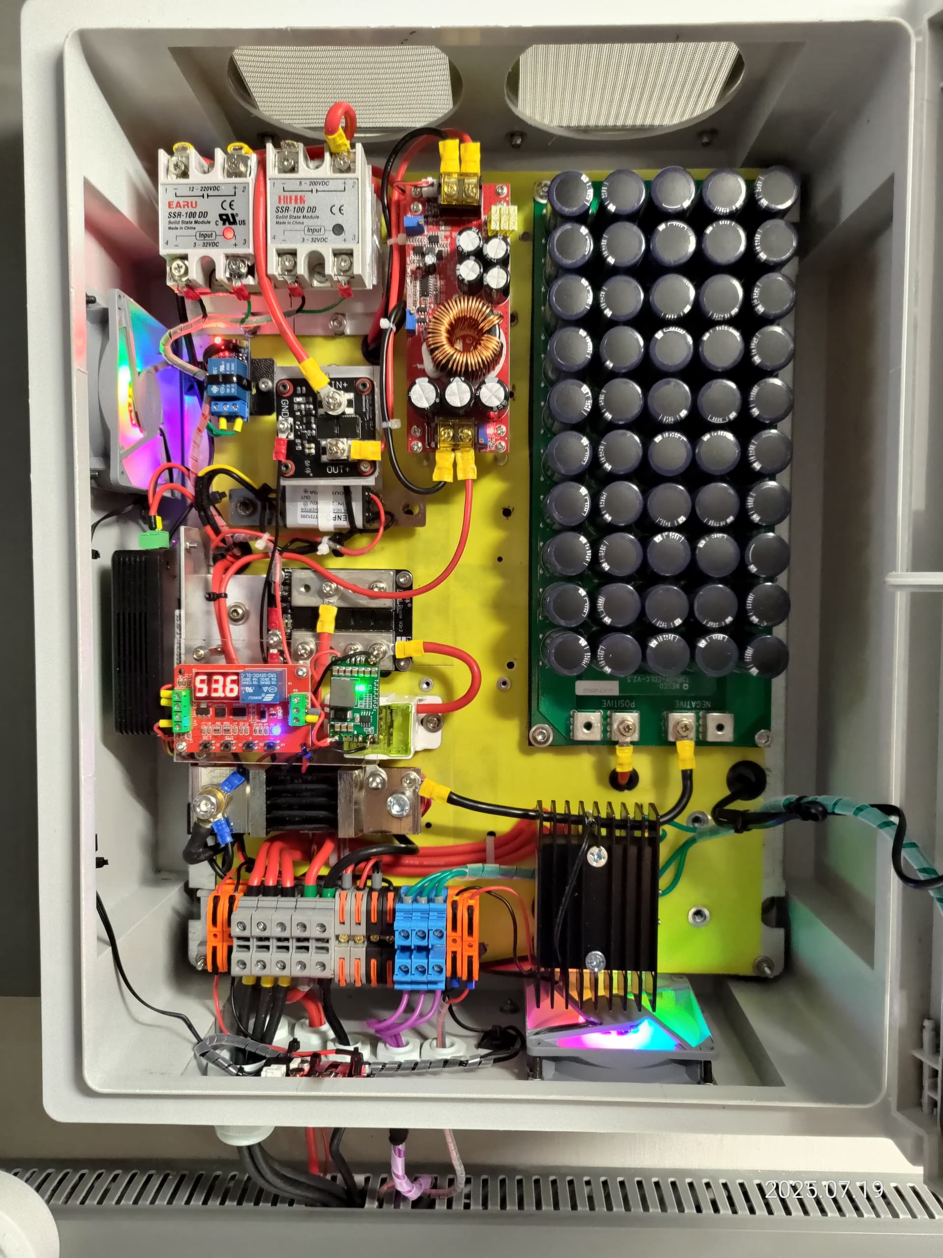

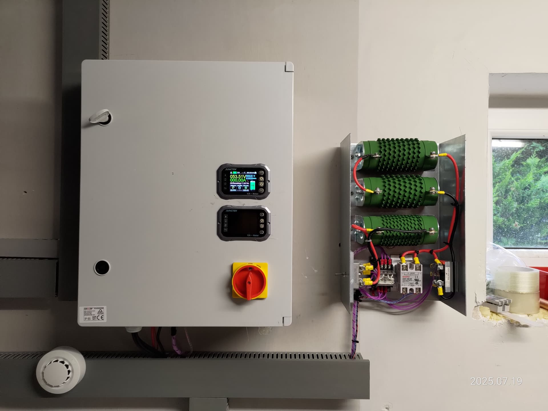

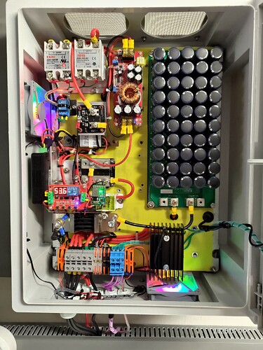

It’s DIY solution . Its controlled by two shunts that switch between three charging states based on generated power first to states charge supercapacitor bank when 30V is reached step up converter send power to battery . First stage is charging capacitor through 300w resistor up to 150w second straight from bridge to capacitor up to 400 w and third straight from the second bridge to battery. Picture show V1 proof of concept. im waiting for parts to improve on the design.

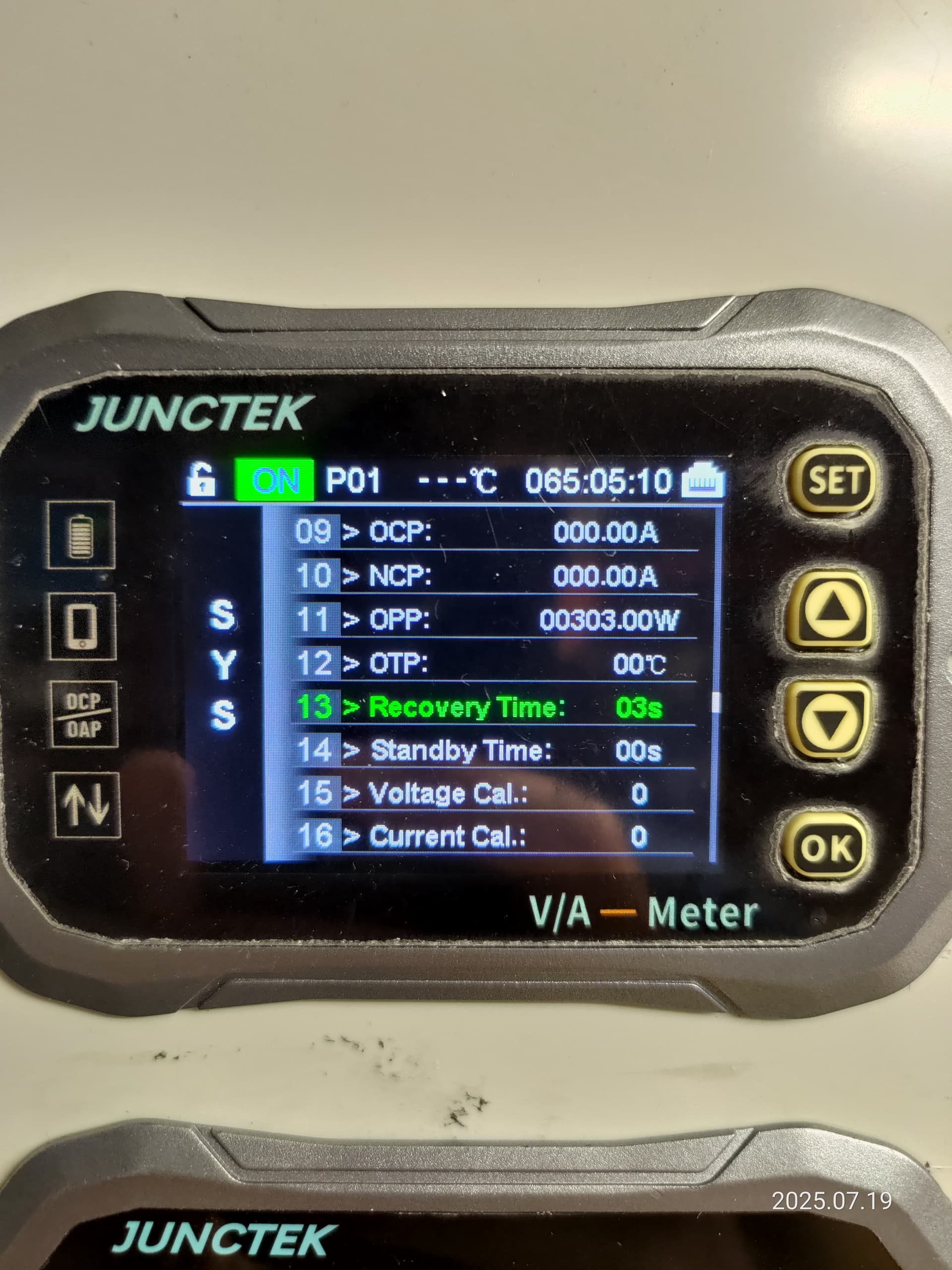

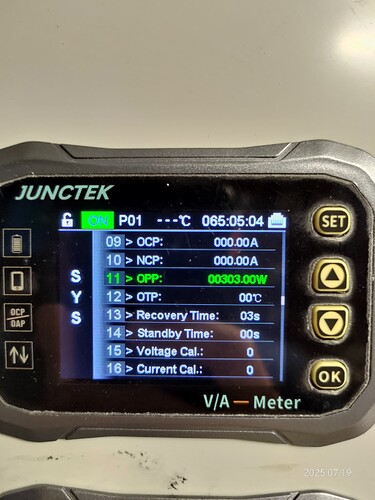

After some testing best solution that works for my i1000 setup is dc-dc step up converter for the first stage , and second stage charging straight from the bridge . Switching between stages is done by junctek shunt OPP set to desired value with programmable delay . Braking through resistors one controlled by voltage comparator another by cerbo relay state of charge cut off.

The cap bank once charged are you shorting out the 300W resistor to allow full dc smoothing and absorb any ripple / surge effect, I assume your not using a BMS system using dumb lead acid batteries as with a BMS in use will need integrating I am going to try with a victron smart Solar not bothered if it brakes as it just a test, would interested in a circuit diagram if you have one, any the original post about VRM not showing on the dashboard the smart shunt setup as wind turbine ,
