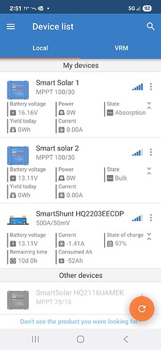

So i had an existing mppt 30/100 controller with 2 200 watt panels and 2 100 ah lithium bats. All great. I added 2 more 200 watt panels and a second 30/100. Also added 2 165 ah lithium bats. All great. Then one day out of the blue charging stopped. The app always reads these values.
This is probably caused by Solar 1 having the wrong battery voltage, and shutting down charging on both (smart networking?).
This is probably a blown fuse or loose connection. Rectify this, then try again…
